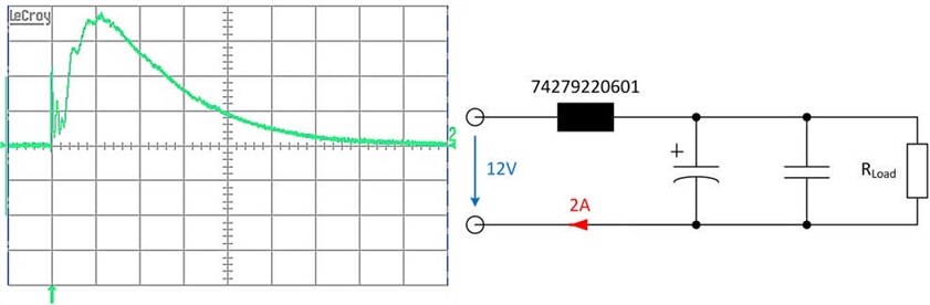

1.1. Application
A typical application is shown in Figure 1. The multilayer ferrite is used as longitudinal filter at the input of the circuit. Due to the low on-resistance of the capacitor, a very high pulse current flows for a short time at switchon.
This pulse current temporarily loads the SMD ferrite with a multiple of the current that is many times above the maximum specified rated current.
In this example, the optimised multilayer ferrite, that is designated by Würth Elektronik eiSos as Multilayer Power Suppression Bead (MPSB), has impedance of 600 ohms for a maximum permissible rated current load of 2.1 A. The one-time current peak in this constellation has a peak value of approx. 19 A and has an overall pulse length of 0.8 ms until it has been reduced to the rated current of the circuit.
Figure 1: Application with peak current at switch-on (5 A / DIV | 100 μs / DIV)image

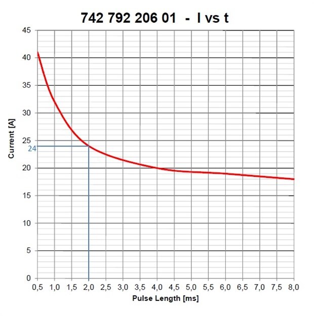

In comparison with the fuse, it is not possible for the multilayer SMD ferrite to specify any generally applicable formula with which conclusions can be drawn about the various current peaks for different pulse lengths using the calculation of the melt integral. The empirically determined data sheet values can be traced back to long term test series with different parameters.
The following shows an example for clarification of the non-applicability of the melt integral for the multilayer ferrites using the example of the article 742 792 206 01 (Z = 600 Ω, IR = 2.1 A, RDC,typ = 43 mΩ).
The WE-MPSB has maximum peak current load capability of 18 A with a pulse length of 8 ms. This produces an I²t value of 2.592 A²ms (18 A @ 8 ms (5 sec pause, 24 °C) I²t = 2.592 A²s).
The following result is obtained if the current for a pulse length of 2 ms based on the I²t value for 8 ms is calculated:
However, the data sheet value shown in Figure 3 is specified as max. 24 A.image
The calculated I²t value deviates significantly from the measured values. Consequently, due to this different behaviour of the SMD ferrite from the fuse, it is not possible to apply the known calculation of the melt integral I²t to a multilayer ferrite.
Figure 3: Specified peak current load capabilityimage

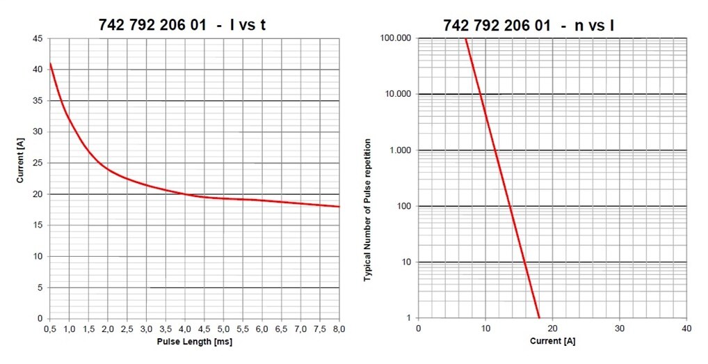

2.2. Definition of the pulse strength
The pulse strength is considered in more detail using the example of the article 742 792 206 01.
The current / pulse curve shown in Figure 5a shows the maximum permitted peak current for the respective tested pulse lengths. The tested range covers the time range of 0.5 ms to 8 ms pulse length. This curve is measured individually for each article and is only permissible for any consideration with one-time pulse.
Figure 4: Display of the current as dependence on pulse length and the number of pulses
The consideration of the permitted maximum pulse current visible in Figure 4b for a repeating pulse is possible using the second curve in the data sheet. This curve is a limit value consideration of the maximum peak current for repeating pulses. A maximum pulse length of 8 ms was selected for determination of the curve.
2.3. Tnt triangle influencing factors
The influencing factors are
  • The pulse lengths t that are tested as standard from 0.5 ms to 8 ms. The longer the pulse, the smaller is the maximum pulse load capability.
  • The number of pulses that are tested from 10 to 100,000 pulses (see Figure 5b). The maximum permissible pulse load capability drops as the pulse frequency increases.
  • The temperature should be noted as third reducing influencing factor; as the temperature increases, RDC increases which results in further reduction of the maximum pulse load.
Each of these interlinked systems is burdened with the dependency on the underlying pause between the individual pulses. In order to carry out an analysis of the linked system with a smaller pause time, it is necessary to measure the temperature [T], pulse repetitions [n] and pulse length [t] influencing factors again.

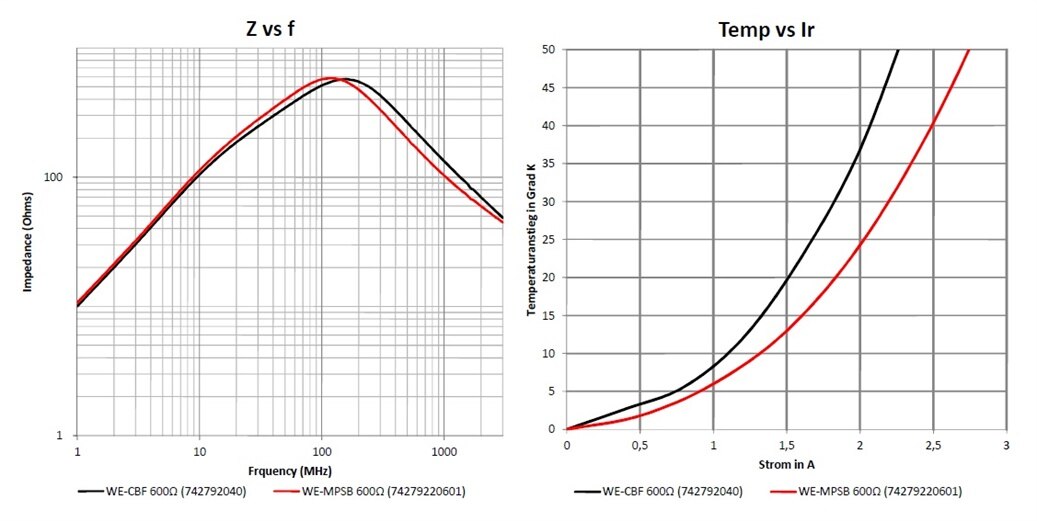

2.4. Comparison of the WE-MPSB with the WE-CBF series
The objective of the WE-MPSB Series is to achieve a comparable impedance as for the WE-CBF Series with additionally optimised resistance and load capability with pulse currents.
Using the example of the 600 Ω models in size 0805 shown in Figure 5, the WE-MPSB Series with almost the same impedance has a higher rated current due to the smaller resistance.
Figure 5: Comparison of the impedance and rated current load capability of the WE-CBF and WE-MPSB 600 Ω

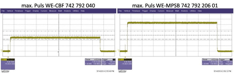

The WE-MPSB Series has significantly higher pulse load capability than a comparableWE-CBF Series model.
Figure 6 shows the maximum pulse level of the 600 Ω model on the graph on the left and the maximum pulse level of the comparable WE-MPSB 600 Ω model on the graph on the right.
Figure 6: Comparison of the different pulse load capability of the WE-CBF and WE-MPSB series
