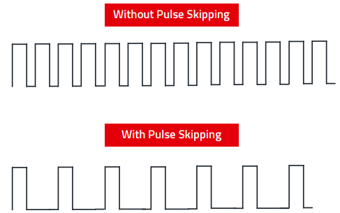

Another operating mode of a buck converter that is similar to burst mode is pulse skipping. As shown in Figure 5, individual or several switching pulses are deliberately skipped in order to keep the output voltage in the desired range. The converter's control loop continuously monitors the output voltage and only intervenes when a correction is required. As a result, the average value of the output voltage remains stable, while the switching frequency is not constant. The effective frequency can fall into the audible range in certain load states if the intervals between the active switching cycles are correspondingly long.

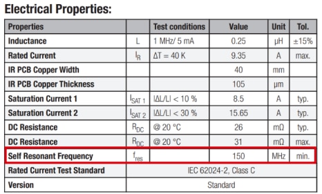

In the context of a circuit, various components and materials are used which have their own resonant frequency due to their mechanical and physical properties. For example, if a coil is vibrated at a frequency of 8 kHz and if the circuit board also oscillates at this frequency, the oscillation amplitude can be amplified by the resonance transmission. This leads to an increase in the sound level, as the resonating body (e.g. the circuit board) amplifies the oscillations of the coil. Without the natural resonance of materials and components, the noise level would be lower and might not even be noticed.
This mechanical-acoustic resonant frequency must not be confused with the resonant frequency specified in the data sheet, which is an electrical property (Figure 6).
Figure 6: Self Resonant Frequency, fres Self Resonant Frequency.
