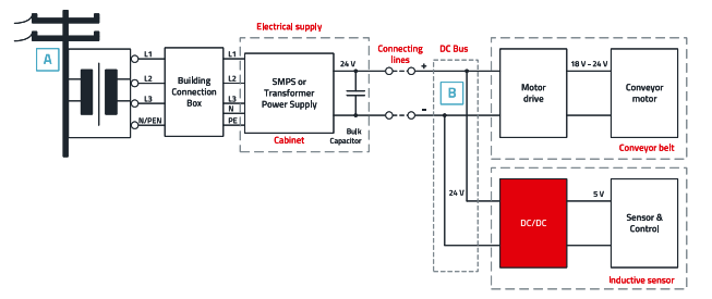

Transient over voltages often occur in industrial environments due to an extensive electrical infrastructure. In order to develop an efficient filter to limit transient over voltages, many influencing parameters must be considered. Today, many industrial applications run on logic input voltage levels such as 5 VDC or lower, as shown in Figure 1. The power distribution system used to power such applications often run on a DC bus voltage of 24 VDC. Switching DC/DC converters are commonly chosen to handle the conversion of the higher DC bus voltage down to the lower logic voltage level.
Figure 1 shows the basic electrical structure of an industry plant. The separated parts of the applications are supplied through a DC bus. On site, every separated electrical load is connected via a sub distribution with 24 V. Non-isolated power modules are implemented to provide the operating voltage of all subsystems.

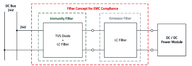

Figure 2: Filter concept for EMC compliance of MagI³C power modules with immunity and emission filter
Figure 2 shows the entire immunity filter concept (green), which includes two stages of filtering. One stage to clamp the high transient overvoltage during a surge event, which can be achieved with transient suppressor components such as unidirectional TVS diodes. For the second stage, a passive LC filter is recommended, which attenuates the voltages that exceed the maximum operating voltage of the DC/DC converter. For optimization purpose the two filter stages could be merged into one filter stage that includes both, the immunity and the emission filter. This application note targets the step-by-step approach with two separate filter stages as this is the easiest.

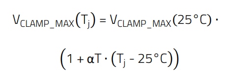

This value can be found in the datasheet as well. For the chosen diode, the voltage is 48.4 V based on a peak current of IPEAK of 31 A, representing a 10/1000 µs pulse. So far, the calculations have assumed an ideal laboratory environment with a controlled ambient temperature of 25°C. However, the reality looks different. From experience an ambient temperature around 55°C is common for electronic devices such as a TVS diode. Therefore, the calculation needs to be modified with a temperature factor. Mainly VCLAMP_MAX and the peak pulse power are strongly dependent on the temperature. Equation (1) shows the temperature effect to VCLAMP_MAX.
image(1)
In the “standby case”, in which almost no current flows through the TVS diode apart from the leakage current of 1 µA, the junction temperature (Tj) is almost the same as the ambient temperature. Assuming a temperature coefficient αT for this type of TVS of 9.9 × 10-4 1/°C, this results in a maximum VCLAMP of 49.84 V at 55°C. This value will be now the starting point for the dimensioning of the second stage of the immunity filter.

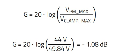

The question now is how to estimate the right filter attenuation and how to get the best filter component values. Starting with the attenuation, the minimum filter attenuation can be calculated with Equation (2).
image(2)
Instead of the symbol A (attenuation) the symbol G (gain) is used. A negative gain means an attenuation.

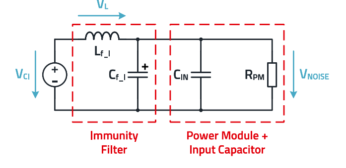

Equation (2) considers the resulting clamping voltage level VCLAMP_MAX of the TVS diode during the surge event and the maximum operating voltage level VPM_MAX of the chosen converter. The task is to design the filter according to Figure 3, where a LC filter circuit needs to be added to the TVS diode.
Figure 3: Equivalent circuit for second stage immunity filter calculation.
The designer, allowing for the calculation of a corresponding filter capacitor, can select the inductor value. The reason for this is that the filter inductor is in series with the application, and therefore its resistance (RDC) causes unwanted losses.
Therefore, the inductor with the smallest possible RDC value concerning the nominal maximum output current of the DC/DC converter should be selected. A WE-PD2 (744776112) with an inductance of 12 µH, an RDC of 336 mΩ and a rated current of 2.72 A was selected for this example filter design.The DC input resistance of the power module can be determined with the given input and output voltage, the output current as well as the efficiency during operation.
Putting these parameters together, Equation (3) for the converter input resistance can be established.
image(3)
Figure 3 shows the equivalent circuit where the TVS diode is represented as a simplified voltage source. The remaining portion of the circuit diagram for the EMC model consists of two LC filters for immunity (surge protection) and emission (EMI attenuation), the input capacitor of the DC/DC converter and the input resistance of the regulator.

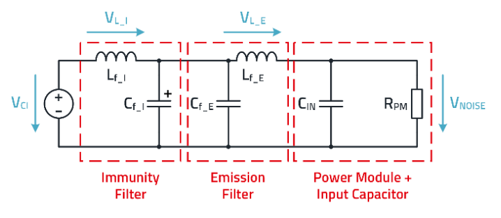

As this is an indoor application and therefore an indirect surge caused by the overvoltage occurs, the following assumptions and calculations are based on an 8/20 µs pulse as defined in the IEC 61000-4-5 standard. For further simplification, it is possible to omit Cf_E and Lf_E since this filter is designed to suppress disturbances at the switching frequency of the power module (Figure 4).
Figure 4: Simplified equivalent circuit for second stage immunity filter calculation.

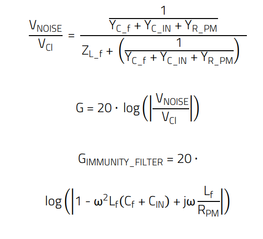

The power module switches typically at 520 kHz. Looking at the frequency spectrum of the surge impulse, one can determine that the highest value of the noise voltage occurs at a frequency of f = 1 kHz. That’s why the over voltage is based on 1 kHz.
To get the attenuation G of the filter, it is necessary to compare the output voltage to the input voltage of the system (Equation (4)).
image(4)

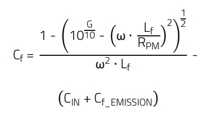

With the previously calculated DC input resistance RPM in of the converter, Equation (5) can be used to establish the necessary capacitor value:
image(5)
Here Lf represents the immunity filter inductor, RPM the DC input resistance of the converter, CIN the input capacitor and Cf_EMISSION the EMI filter capacitor of an input PI filter structure. The values can be found in the datasheet of the power module 173010535. Assuming the use of a 12 µH inductor, the calculation result for the filter capacitor is Cf = 218 µF. Checking the standard values for capacitors, a value of 220 µF (860010775018) is chosen as it is larger than the calculated value. A value less than the calculated capacitance would not provide sufficient attenuation of the filter. The final filter selected components are as follows: TVS diode = 824550301, Lf_I = 744776112, Cf_I = 860010775018.

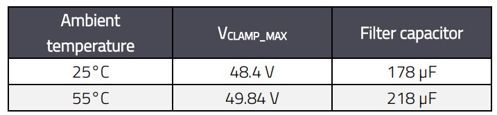

The influence of the temperature on the VCLAMP_MAX and thus on the value of the filter capacitor, is shown in Table 1.
Table 1: Temperature influence overview
The capacitor values have been calculated, but real capacitors are subject to relatively high tolerances. The actual capacitance value can vary by up to ±20 %. If the temperature dependence of the VCLAMP_MAX is not fully accounted for, a capacitor with too low a capacitance value may be selected.

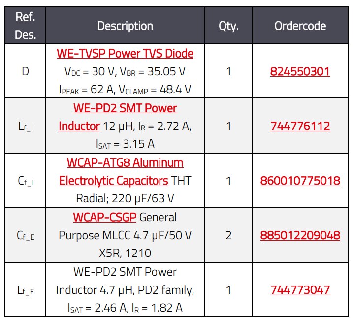

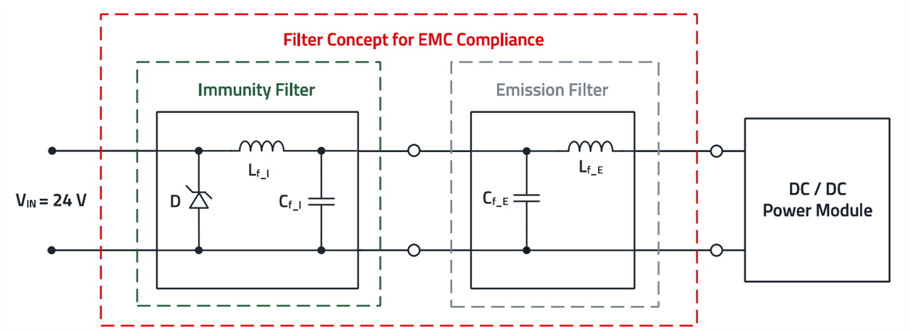

Figure 5 shows the complete EMC concept for the immunity and emission filter. The values for the components used, are shown in Table 2.
Table 2: BOM for immunity and emission filter.
Figure 5: EMC compliance filter concept of MagI³C power modules with immunity and emission filter.
