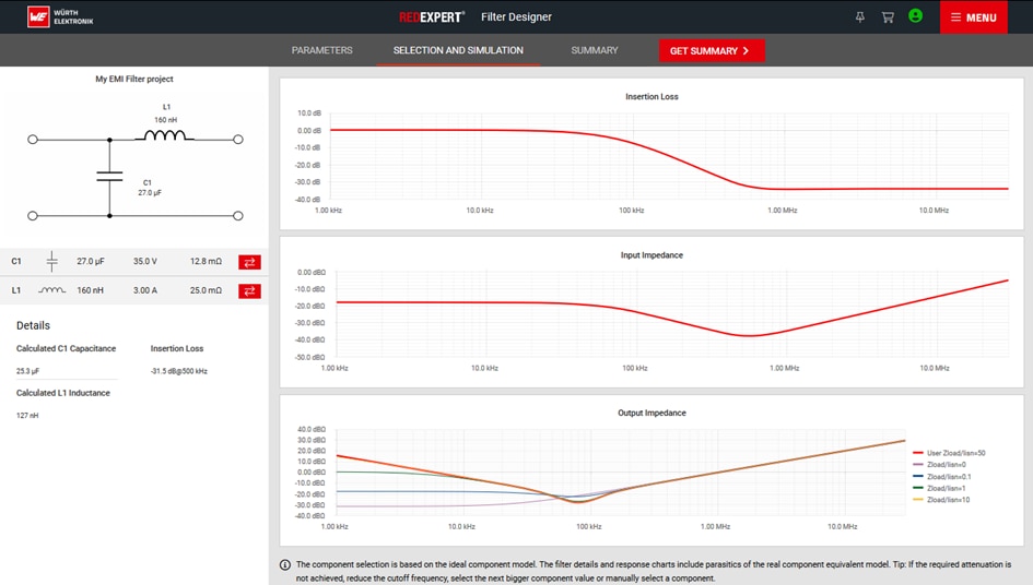

Now, you can select “Next” to see the component selection and simulation page. This page will show the recommended components; for our example, it is recommended that we use a 27.0 µF capacitor and a 160 nH inductor as shown in Figure 3.  You will also see the C1 capacitance, L1 inductance, and insertion loss values; in this example, they are 25.3 µF, 127 nH, and -31.5 dB at 500 kHz, respectively. The charts to the right showing the Insertion Loss, Input Impedance, and Output Impedance are based on the real parasitics of the components. The buttons with the double arrows opens a window where you can select alternates parts or values and even add specific parts that are not listed.
Figure 3: Selection and Simulation page of REDEXPERT Filter Designer.

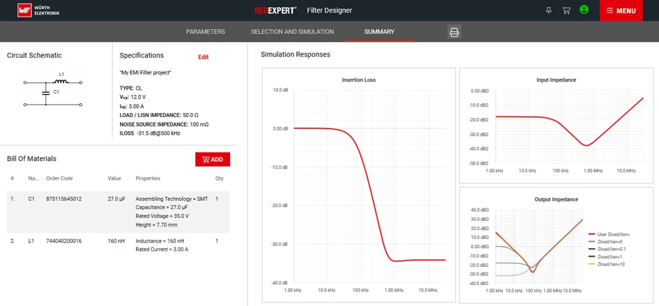

Hitting “Get Summary” will take you to the summary page where you can see the exact components in the Bill of Materials for your filter as well as an overview of the specifications and graphs.
For our design, we were recommended this WCAP-PSHP Aluminum Polymer Capacitor and this WE-LQS SMT Power Inductor.
Figure 4: REDEXPERT Filter Designer Summary Page.
