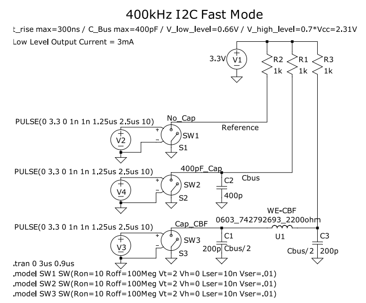

06. LTSPICE SIMULATION WITH 400 KHZ CLOCK RATE
With the help of the free simulation program LTspice it is relatively easy to investigate the influence of the parasitic bus capacitance in combination with the selected pull-up resistors. In order to generate the desired useful signals, it is advisable to use a voltage-controlled switch. With the help of the voltage source practically any periodic signal can be generated. For this purpose, the "Pulse" function is selected and the desired bandwidth is determined on the basis of the desired I²C specification. For the widely used 400 kBit/s variant, a period duration of 2.5 µs is selected. For a 50% duty cycle, the "high" time is set to 1.25 µs. In order to determine the edge steepness of the signal, one needs to get the rise times from the datasheets of the ICs being used on the bus. To be able to use the maximum allowed 400 pF parasitic bus capacitance, the pull-ups were set to 1 kΩ. Three channels (may represent SCL or SDA in practice) are simulated:
  • Without parasitic bus capacitance
  • 400 pF parasitic bus capacitance
  • 400 pF + wideband multilayer SMT ferrite (742792693)
Figure 3:  Schematic LTspice simulation with 3 channels --> 0 pF, 400 pF & 400 pF + Multilayer SMT Ferrite

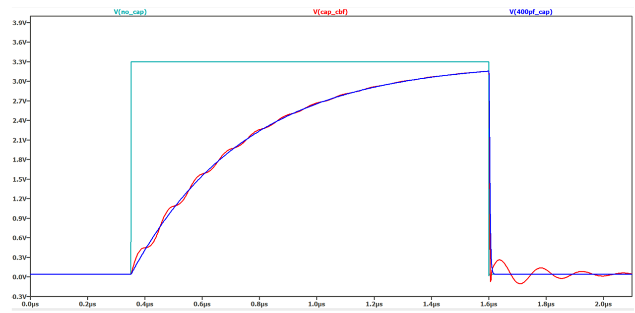

Figure 4:  LTspice simulation result time domain 0 pF (Turquoise), 400 pF (Blue) & 400 pF+ Multilayer SMT Ferrite (Red)
The simulation result shows that practically no influence on the rise time of the signal can be expected from the multilayer SMT ferrite. Because each multilayer SMT ferrite also has an inductance component, minor oscillations are visible in combination with the bus capacitance. However, these are not critical because their amplitudes are less than 10% of the actual useful signal. In the real measurements, these oscillations are significantly lower.

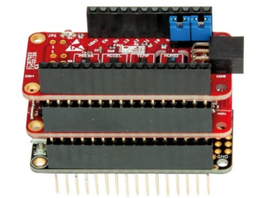

To verify the relatively simple LTspice simulation, additional measurements were performed on a Würth Elektronik SensorBLE FeatherWing Kit. (Figure 5)
Figure 5: : Würth Elektronik SensorBLE FeatherWing Kit

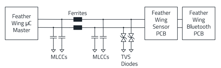

This kit consists of a master board, which contains the microcontroller. The other two contain a WE Bluetooth module and various WE sensors (3-axis acceleration, temperature, humidity, pressure). The master board communicates with the other two via I²C bus at a maximum data rate of 400 kBit/s. The sensor data can then be visualized with a suitable smartphone app (WE-SensorBLE). A parasitic capacitance of 400 pF with respect to GND was simulated using MLCCs. The same multilayer SMT ferrite (742792693) was used as in the simulation, plus a TVS diode array (824012823). In addition, 20 cm of cable was used to connect the sensor board to the rest of the I²C. Such an arrangement can be observed in many applications in practice.
Figure 6: Block diagram test setup with Würth Elektronik SensorBLE FeatherWing Kit

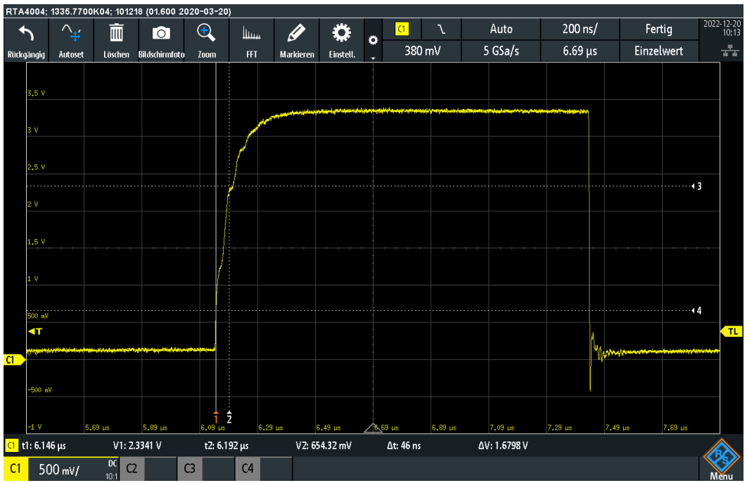

The voltage curve on the SCL line was always measured.
Figure 7: Reference measurement with 1 kΩ pull-ups without further changes of the used FeatherWing hardware (= 46 ns rise time)
Figure 8: : Reference measurement with 1 kΩ pull-ups + multilayer SMT ferrite + TVS diode array + 20 cm cable (= 46 ns rise time)
Figure 9:  Reference measurement with 1 kΩ pull-ups + multilayer SMT ferrite + TVS diode array + 20 cm cable + 400 pF MLCCs (= 344 ns rise time)
The measurements show practically identical results to the simulation. The rise time and signal quality are not negatively affected by the multilayer SMT ferrite in combination with the TVS diode. The rise time of the high signal, which is critical for the timing, depends only on the bus capacitance in combination with the selected pull-up resistors. Using the smartphone app (WE-SensorBLE), errorfree operation could be verified in all three tested scenarios.
