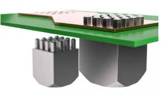

1. THE PRESS-FIT TECHNOLOGY
REDCUBE PRESS-FIT terminals stand out as the go-to choice for robust high-power connections at the PCB level in automotive applications. They're widely employed for connecting wiring with cable lugs to circuit boards. The current rating of REDCUBE PRESS-FIT is seriously impressive. Even with the same power output, these components generate the least amount of heat compared to alternatives for powering PCBs.
Figure 1: PRESS-FIT Technology.
By pressing the pins directly into the PCB, there's a strong friction between the pin and the plated through-hole, creating a seamless cold-welding connection between the pin and the copper-plated via within the PCB. This delivers a secure, gastight, and mechanically strong connection with a contact resistance of less than 200 µOhm. No other technology matches the ability to handle currents up to 250 A with such minimal self-heating.
In terms of long-term reliability, REDCUBE PRESS-FIT surpasses a surface-mount technology (SMT) solder joint by up to 30 times. A single solid press pin typically requires a force of 100 N to extract it from a 1.6 mm PCB.
So, even a small component with 8 pins could handle the weight of an average person without being pulled out of the PCB. This makes REDCUBE PRESS-FIT Terminals ideal for offering both electrical and mechanical connection solutions for electronic components. If after pressing the connector into the printed circuit board, the solid press pin interference on each of the four corners is greater than 3° against the via sleeve, the press connection zone exhibits lower electrical resistance than the brass pin itself. This ensures there's no electrical or thermal bottleneck. The example in Figure 2 shows a cross-section of the pressed pin in the via. Typically, the connection surface angle is significantly larger, offering ample safety margin for the electrical connection.
Figure 2: Required connection angle only 3°.
The 3° refers to the to a portion of a full circle’s 360° At the same time, this area should not exceed 12°, otherwise, the via copper plating can be damaged. The values specified in the data sheet ensure compliance with this requirement.
Press-fit technology offers several advantages over solder technology. It's particularly adept at handling very thick circuit boards with heavy copper plating. Additionally, it allows for trouble-free two-sided mounting of circuit boards, facilitating compact module designs.
With Press-fit technology, there's consistent contact between the pin and the copper layer along the entire length of the press-fit zone. This reliability is not assured with soldering, as solder may not fully rise along the entire length of the via, leading to increased transition resistances.
Consequently, the long-term reliability and mechanical stability are not as robust as with REDCUBE PRESS-FIT. Unlike soldering, this process does not subject the circuit boards to thermal loading.
REDCUBE PRESS-FIT connectors from Würth Elektronik are crafted from CuZn39Pb3 material, ensuring they comply with RoHS standards regarding copper alloys.
