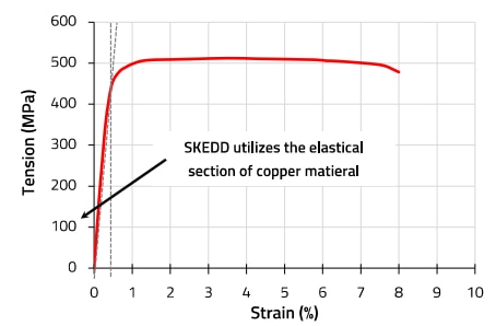

In conventional press-fit connections using solid pins, the high forces applied during the joining process create a permanent, non-detachable connection between the contact partners. The plated through-hole of the printed circuit board adapts to the contact because of the press-in process. With SKEDD technology, no permanent deformation of the plated through-hole occurs. Only the SKEDD forks are preloaded and return to their original position after the connection is released. In other words, SKEDD utilizes the elastic range of the copper material (see Figure 1). A sufficiently large elastic range is essential for compensating hole and positional tolerances while maintaining an adequate normal contact force. This range is influenced by the selection of suitable materials and by a design that provides an optimal balance between stiffness and elasticity.
Figure 1:  Tension and elongation behavior of copper material

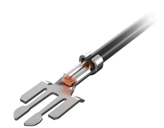

In addition to improved electrical properties, the mechanical stability has also been raised to a new level. Thanks to SKEDD technology, both inserting the contact into the housing and the connector into the printed circuit board can be done manually without tools. This eliminates the need for both the soldering process and a mating connector. For the connection to the wire, well-established crimping technology is used. Figure 2 shows the REDFIT Crimp system with contact and connector in the unmated condition.
Figure 2: SKEDD Crimp contact

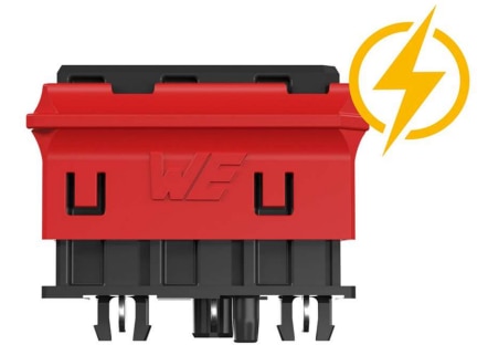

As mentioned previously, the new REDFIT version is designed for power supply applications on the printed circuit board. With a current-carrying capacity of 16 A at an operating voltage of 400 VAC, it is also ideally suited for mains power applications.
Figure 3: REDFIT Crimp for power supply

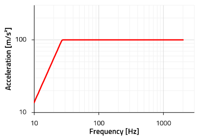

Thanks to the newly developed and patented mechanical locking mechanism, forces up to 10 g can be withstood without mechanical or electrical failure. Conventional connectors are typically tested at 5 g over frequencies from 10 to 55 Hz. Figure 4 shows the process of how the connector is tested for vibration. The acceleration acts on the connector for a duration of 7.5 hours with up to 10 g. This ensures that no mechanical or electrical failures occur under high mechanical stress. A sinusoidal frequency sweep from 10 to 2000 Hz is tested.
Figure 4: Vibration curve 10 g (10 to 2000 Hz)

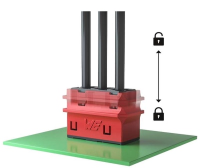

During the development of the active locking mechanism, special emphasis was placed on user friendliness. After manually inserting the REDFIT connector into the printed circuit board, the collar is simply pushed down to its lowest position. In this position, a locking dome secures the latching tabs in the PCB, providing both tactile and audible feedback to the user. This ensures stable mounting, making the connector suitable even for mechanically demanding applications.
Figure 5: Positive feedback when locking with slider

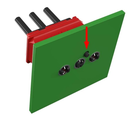

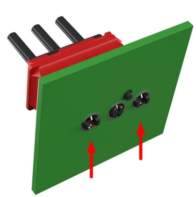

An additional plastic pin prevents accidental reverse polarity of the contacts. An extra marking on the housing indicates the position of PIN 1 in ascending order.
Figure 7: Plastic pin assures correct polarity.

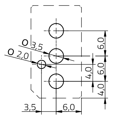

06. PCB LAYOUT The REDFIT

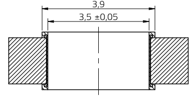

Crimp connector requires a PCB thickness of 1.6 mm. For optimal electrical and mechanical connection, the tolerances used for press-fit technology should be applied during PCB manufacturing. The PCB plating can be done with chemical tin, ENIG, or HAL. The pad size is negligible, as the contact is formed within the sleeve. However, the pad is required for PCB production. Thus, the annular ring size can be minimized. The drill hole specifications are shown in Figure 8. The plated through-hole should have a final diameter of 3.5 mm.
Figure 8: Drill hole and plating specification (in mm)
Figure 9 shows the recommended layout for a REDFIT Crimp with three pins. Since the mechanical fixation also occurs within the plated through-hole, no additional mounting points are required. Depending on the application, the REDFIT Crimp can also be mounted in the opposite insertion direction. In this case, the layout simply needs to be placed on the desired side of the PCB.
Figure 9:  PCB Layout (in mm)

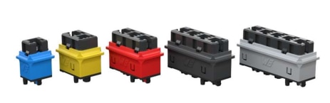

The REDFIT Crimp is available in configurations from 1 to 5 pins. Visual coding can be achieved using differently colored connector collars. The collars are available in red, blue, yellow, black, and white.
Figure 10: Color-Coded to the number of pins
