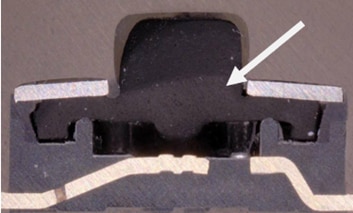

To build a house, we need bricks and cement to seal the air gaps.  Similarly, for a mechanical switch, we need also some additional protection or ingredients to the component to make it more protected from fluid ingress. And recent solution is to use silicone rubber no matter in which form or shape and the function of the rubber is to is to be designed in such a way that it closes or minimizes the air gap between the spare parts
But does using silicone rubber automatically mean the switch is airtight ?
Take a look on these two pictures:  they show two different internal structures both using silicone rubber inside a switch.  One silicone rubber is placed on the gap between the cover and the base., In the other , it is  placed above the stationary contact to protect it .
Which one do you think performs better when water flows from top to bottom?
image  image
(Picture on right:, air gap on the red line areas between cover and base)
So, even when silicone rubber is used, it does not mean the switch is sealed.
What we want to express is that, that even with silicone rubber inside the switch, without a proper design to close or tighten the possible air gap it is not possible to achieve the sealing function for a mechanical switch.
