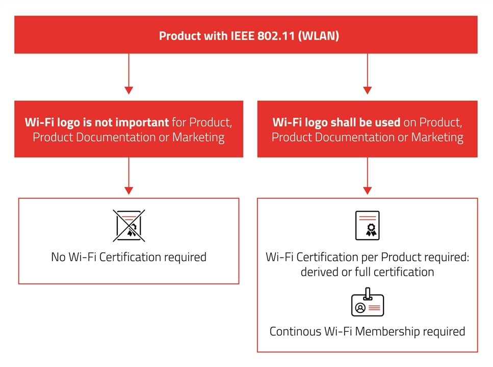

Wi-Fi (wireless fidelity) is a specification for ensuring interoperability, based on the IEEE 802.11 family of standards, which are commonly used for local area networking of devices and Internet access. Wi-Fi is a trademark of the non-profit Wi-Fi Alliance, which restricts the use of the term Wi-Fi Certified to products that successfully complete interoperability certification testing.

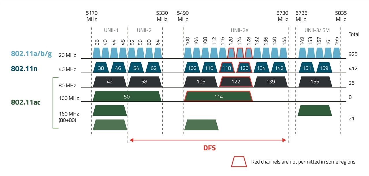

The different versions of Wi-Fi are specified by various IEEE 802.11 protocol standards, with the different radio technologies determining radio bands, and the maximum ranges, and speeds that may be achieved. Wi-Fi most commonly uses the 2.4 gigahertz and 5 gigahertz radio bands; these bands are subdivided into multiple channels (see figures below). Channels can be shared between networks but only one transmitter can locally transmit on a channel at any moment in time. As Wi-Fi implements CSMA/CA/listen before talk propability of collisions on the same channel can be minimized, but they cannot be reduced to p = 0.
2.4GHz Channels
5GHz Channels
