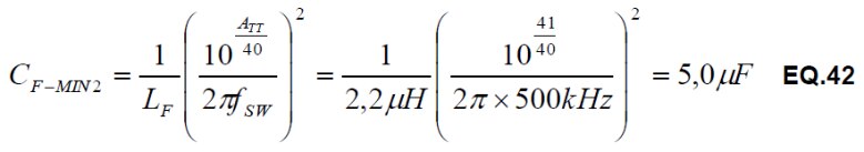

The second equation is a hard limit, and it predicts the minimum capacitance needed to ensure that the voltage ripple at the input to the converter is below the limit set by ATT:
The capacitor chosen should be greater than the larger of the two values given by CF-MIN1 and CF-MIN2, and multi-layer ceramic capacitors are the best choice. When using MLCCs the loss in capacitance due to a DC voltage bias must be taken into account. Depending upon the case size and voltage rating it would likely take two or more 10 μF capacitors in parallel to provide a true 14 μF or more of capacitance. Before selecting the final value for CF, however, the damping of the input filter must be considered.
