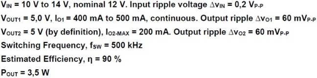

3. Design Example
The following equations and design philosophies will guide the user through the steps needed to add a secondary output to a non-synchronous buck regulator using a control IC with a fixed current limit. Most buck regulator ICs with internal power MOSFETs have a comparator that monitors the current flowing through the control or “high-side” MOSFET (Q1 in Figure 1), which is equal to the main inductor current when this MOSFET is on. Good quality ICs will specify a minimum threshold for this current limit over the full range of operating temperature, and in most cases when this limit is reached the IC will immediately turn the MOSFET off. As will be shown, this represents a maximum output power that must be shared between the main output and the secondary output. For the design example the IC used will be the TPS54160 from Texas Instruments. The Electrical Characteristics table of the datasheet states that the minimum current limit threshold over the full temperature range is 1,8A. The design specifications are as follows:
The selection of the external components is the same regardless of how the secondary is connected; hence these calculations are valid for the cases shown in Figure 1a, 1b and 1c.

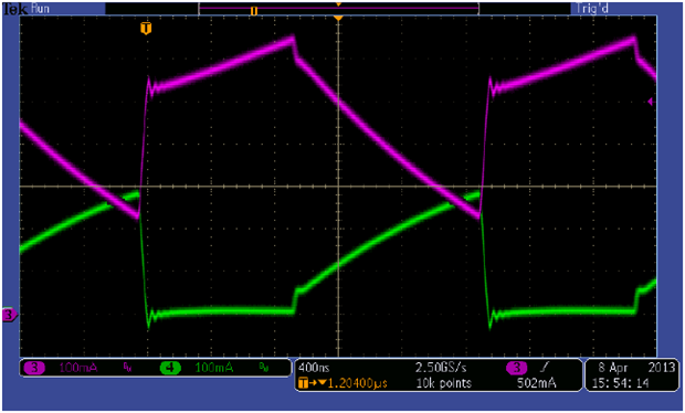

Figure 2: Primary (pink) and Secondary (green) Currents in the 1:1 Coupled Inductor
It is important to distinguish between the average current and the DC current for the secondary. “Average Current”, IS-AVG, refers to the average height of the trapezoid waveform. “DC Current”, IO2-MAX, refers to the average current delivered to the load on the secondary. These two currents are not the same value, and much confusion can result from mixing them up. For clarity, the Average Current of a trapezoid waveform is equal to the DC Current divided by one minus the duty cycle. For the case of the secondary in a 1:1 coupled buck the maximum values are of interest for worst case calculations:

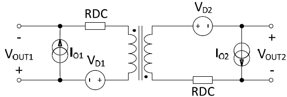

Calculating the ripple current in the secondary is unfortunately much less straightforward. This quantity is highly dependent upon the leakage inductance of the 1:1 inductor, the load current, the forward voltage drop of the output diode, and the DC resistance (DCR) of the inductor windings (Figure 3).
Figure 3: 1:1 Inductor with 1st Order Parasitic Components and Voltage Drops
Closer inspection, especially at higher secondary output currents reveals that ∆iS is not purely triangular, but is in fact a parabola due to the trapezoid waveform of the voltage applied across the leakage inductance. An approximate equation is given here, based upon the assumption that the average voltage across the leakage inductance is constant and is equal to the forward voltage of the output diode:
The difficulty in using this expression stems from accurately measuring the leakage inductance and from accurately predicting (or measuring) the diode voltage VDS. Leakage inductance is not always specified by inductor manufacturers, but it can be measured by short-circuiting one set of terminals of the inductor and measuring the inductance of the other terminals. For this example LLEAK was measured as 3,1 μH. Diode voltage must be assumed, hence a value of 0,5 V will be used.

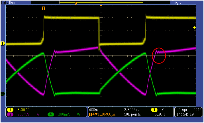

The second limitation comes from the boundary between Continuous Conduction Mode (CCM), where the current in the primary winding never reaches zero, and Discontinuous Conduction Mode (DCM), where primary current falls to zero before the end of the switching cycle. This limitation applies to non-synchronous buck converters and some synchronous buck converters if their control ICs do not allow inductor current to reverse polarity. Once the converter enters DCM the average voltage across the primary winding is less than VOUT1. VOUT2 tends to droop or even collapse, depending upon the load current it supplies. For all switching regulators the CCM/DCM boundary can be defined as the point when average inductor current equals onehalf of the ripple current. Referring back to Figure 2, it is clear that this condition is most likely to occur when primary load current is low and secondary load current is high.
Writing a useful equation is difficult because of the high variability of the secondary ripple current and its dependence upon the non-linear relationship of the secondary output diode forward voltage to forward current. Lab testing is the best way to determine when the converter will enter DCM, and a current probe will show the exact point where primary current hits zero. If a current probe is not available, then a voltage probe and a multimeter will work. Figure 4 shows the switch-node voltage of the primary (where the control FET, inductor primary and diode all connect) just in DCM. The voltage probe will reveal the onset of a damped oscillation before the end of each switching cycle, and a multimeter will show the rapid drop in VO2 once DCM is reached.
Figure 4: Primary switch node voltage (yellow). The section circled in red indicates DCM.

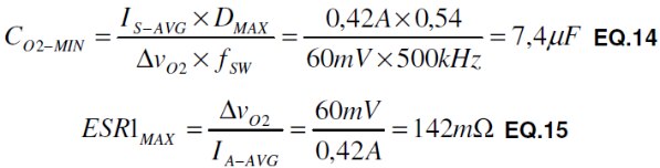

9. Output Capacitors
Capacitors for smoothing the voltages at the converter outputs are selected with a similar philosophy as the inductor, but with a focus on maintaining a given maximum peak-to-peak ripple voltage instead of a ripple current. For the main output the ripple voltage is a function of the output capacitor´s impedance at the switching frequency and the peak-peak ripple current. The following equations assume that half of the impedance is due to the capacitive reactance, and half comes from the equivalent series resistance (ESR):
For this example, a solid tantalum capacitor with 220 μF and ESR of 40 m  meets both requirements and provides much extra capacitance for responding to load transients. As a general practice, any time tantalum, aluminum or other high-ESR type capacitors are used at a switching converter´s input or output a 100 nF multi-layer ceramic capacitor (MLCC) placed in parallel will help reduce high frequency noise. The secondary output requires that CO2 both filter and hold up VOUT2 while the control FET is on. This requires both higher capacitance and a higher RMS current rating for an output of the same power. Fortunately VOUT2 only delivers a maximum of 200 mA. Minimum capacitance and maximum ESR are determined as follows:
Here it is important to calculate the RMS current as well:
Tantalum and aluminum capacitors are possibilities, but in the face of heavy RMS current, MLCCs are the best choice. For this example a 22 μF device rated at 10V with X5R dielectric and 1210 case size will be used. The ESR is approximately 3 m  and the RMS current rating is about 3 A. One important consideration for MLCCs is their loss of capacitance under a DC voltage bias. This particular capacitor drops to about 16 μF when used at 5 VDC.

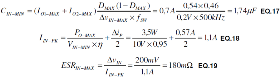

10. Input Capacitors
Input ripple voltage is often overlooked, but plays a vital role in conducted EMI. Input capacitors to buck regulators must withstand a discontinuous, heavy RMS current because they supply most of the AC current to the converter when the control FET is on. As with the secondary output capacitors, after minimum capacitance and maximum ESR have been selected, the capacitor or capacitors chosen must be evaluated for their RMS current ratings.
The RMS current through the input capacitor is calculated as:
MLCCs are again the best choice due to their low ESR and high RMS current ratings. Here, a 25 V rated 10 μF device with X5R dielectric will be used. When biased at 14 V, the actual capacitance is approximately 7 μF.
