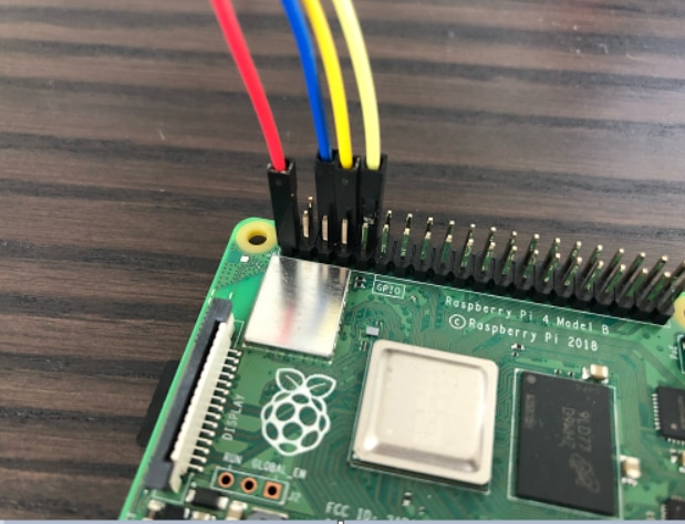

Next to the plug-and-play USB interface, Raspberry Pi boards offer various other interfaces that allow you to communicate with MTi devices. For this article we used the mini UART interface that is accessible via the GPIO pins 14 (TXD) and 15 (RXD). We also used the 5V/3V3 and Ground pins to power the MTi.
Note: The configuration and availability of the UART interface varies between Raspberry Pi models. For this article we first had to enable the mini UART. Refer to this article for more information.
Note: The UART interface of an MTi 1-series Development Board will be disabled when the board is powered at 5V. Use the 3.3V output of the Raspberry instead.
