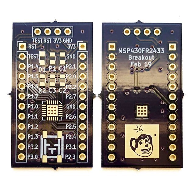

    Thanks.... I have some concern about how much detail will be captured in such a small board.  I did do some simple PCB art a while back using OSHPark and my own hand drawn image before I had seen the video linked above.  It is two layers only with solder mask and ENIG over copper but shows how much different the actual results can be from the renders.  The results in that instance look much better than the OSHPark renders in my opinion.
