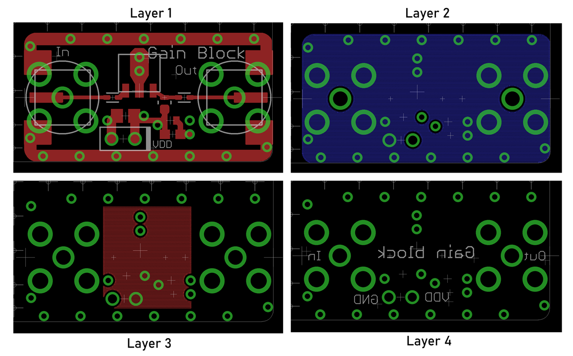

    Here's an example where only three layers are used (layer 1 for signals, layer 2 for ground plane, and layer 3 for power plane only where it was needed, there was no significant benefit in extending it), and it was unnecessary to have a 4th layer because there were no signals on the bottom layer. Some would argue this could have been a 2-layer board, but it's an easier transmission line at the desired impedance with 4-layer due to the distance between the top two layers. This board operated from tens of MHz to close to 2 GHz.
