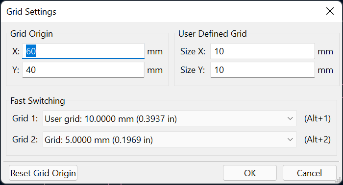

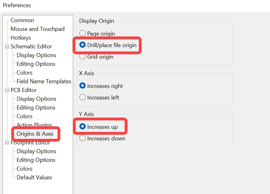

After installing KiCAD, I had to make some preference adjustments (click on Preferences->Preferences in the schematic editor), in order to get the control to something like what EAGLE offered. For me the most important were those highlighted in red below. With these settings as shown in the screenshot, the mouse control felt better.
I also changed the grid options to the following:
The grid for footprint editing also needed changing (for me):

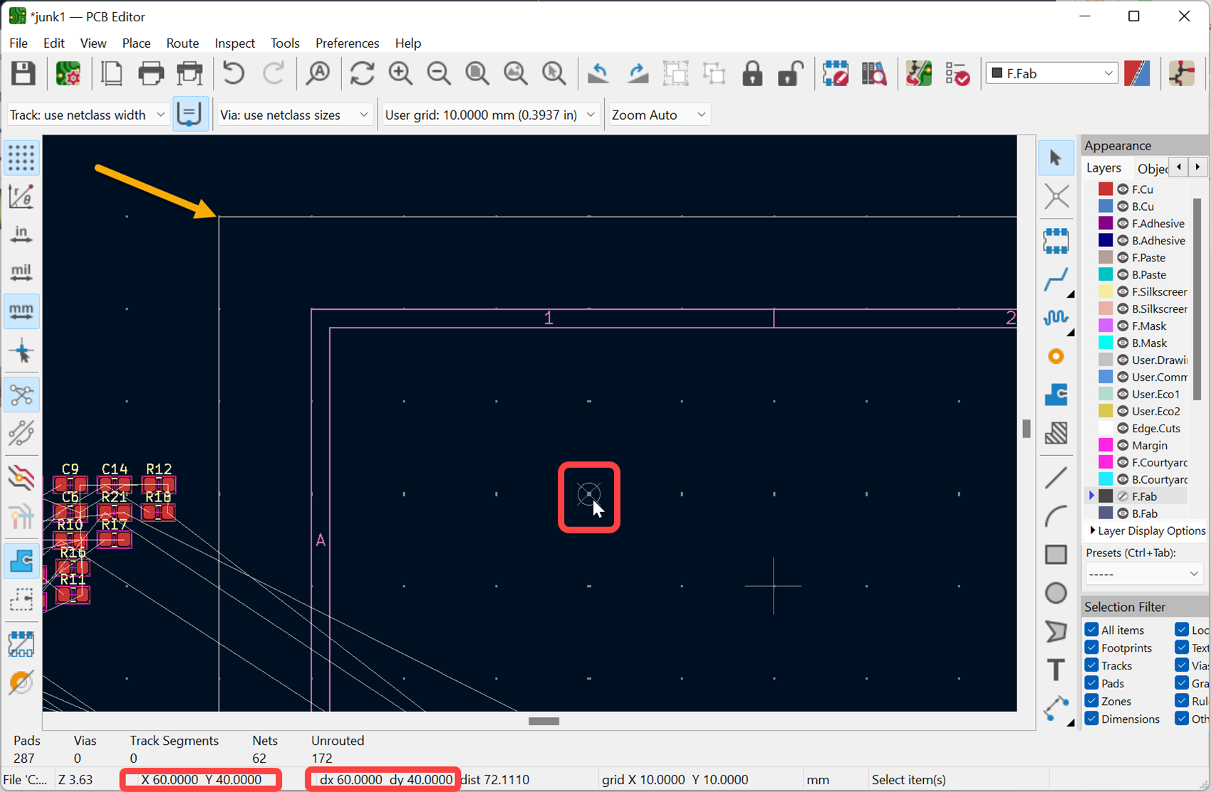

Also, the following is quite important, particularly the Display Origin. Without the Display Origin set as shown in the red box in the screenshot below, when it comes to PCB layout, you won't be able to have the corner of your board (or the center of your board, depending on your preference) at an origin point easily. With the setting as shown below, you can move the origin when you're doing the PCB layout using the Place->Drill/Place File Origin menu option
The Y Axis setting below is only useful if you want your y-co-ordinate values to increase as you go up the page in the PCB editor, which is how it works in EAGLE.:
Now things feel much better!

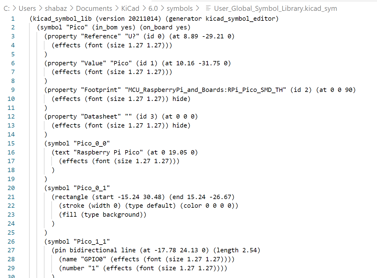

From my perspective, the way I'm working so far is to create my own symbol and footprint libraries (they are separate in KiCAD, whereas in EAGLE it is all in one library file), and then do 'Save As' to save existing symbols or footprints to my own library, whenever I feel the need to edit a symbol or footprint from any source library. I am using 'Global Libraries' (there is an option to have project specific libraries).
For instance, I needed a Pi Pico symbol and footprint, and found them online (not ventured into creating my own symbols and footprints with KiCAD yet on day 1,but did it later, see further below).
Then, I edited them, and did 'Save As' to save to my own library which I named User Global Library for now. A tidier scheme would be different libraries, but I might over time just add my personal popular symbols into this single library. Unless it grows hugely, I'm assuming it doesn't matter too much because it is easy to find items since there is a search box when you add components or footprints.

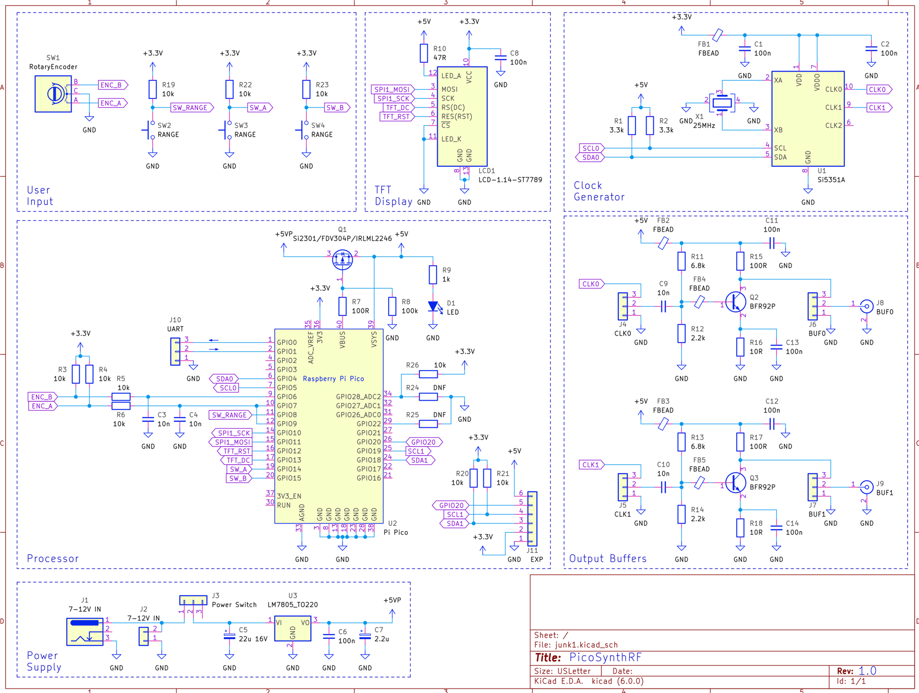

The screenshot below shows the schematic editor with my modified Pi Pico symbol on the left, versus the downloaded one on the right. It could be improved further by collapsing all the GND pins into a single one, but I still need to learn how to do that. For now, I'm happy with the symbol.
Unlike EAGLE, component references (like R1, R2 etc) are not automatically numbered, you have to go to Tools->Annotate Schematic and then click OK, and it will auto-annotate. I don't know of a way to make it automatically annotate in real-time.

I got a lot further in days two and three, and have completed a full schematic entry, and along the way created a couple of parts (footprint and symbols), as well as edited a few footprints/symbols too.
Throughout, what I've been doing (I don't know if this is best practice or not) is that whenever I see a symbol or footprint that I'd like to tweak, I right-click, Save As and then save it to my User library with either the same name or a different name, and then edit it there. So, now my User libraries for symbols and footprints now look like this after one schematic entry:
During schematic entry, I mostly assigned footprints as I added each component, so that then I could copy-paste from the schematic and know that everything had a footprint assigned. But later I discovered Tools->Assign Footprints which works like this:
The right/left arrows at the top of the screenshot above are used to navigate through any components that are missing assignments, and then the three columns are used to pick the footprint library and the specific desired footprint. Right-clicking on the footprint name allows you to bring up a graphic view of it.
In EAGLE, there was a mapping table that the user had to fill in to map footprint pad numbers to symbol pin numbers. It seems there is no such table for mapping like this in KiCAD Anyway, I'm happy either way, it is one less step if there is no need for a mapping table.
It appears that as shown in the green areas in the screenshot above, the connection pin named 1 on the symbol automatically associates to the pad numbered 1 on the footprint, and so forth for all the remaining numbered pins and pads. If you want lots of pads on the footprint to all to connect to a single pin on the schematic, then just number all those pads with the same value. For instance, here a tactile switch footprint I created with 8 through-hole pads, but they are all just numbered 1 or 2 since the switch symbol will only have two connections. This is less flexible than EAGLE, but I really don't mind in this particular area - I might come to prefer this KiCAD method over time:
By the end of day three, I had a schematic complete, and all symbols have assigned footprints.

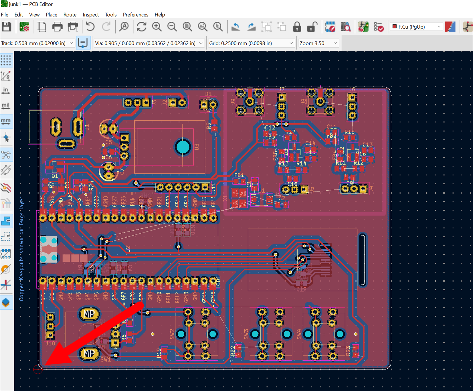

I drew a PCB outline using the Edge.Cuts layer, and then moved the origin to be at one corner of the board, so that I could easily position things that needed to be at specific locations on the board (like buttons and connectors and so on). To move the origin, the menu item Place->Drill/Place File Origin is used, and then click on the location that you wish to be the origin (see the comments below how to set up another origin for relative measurements, since that could be handy too).

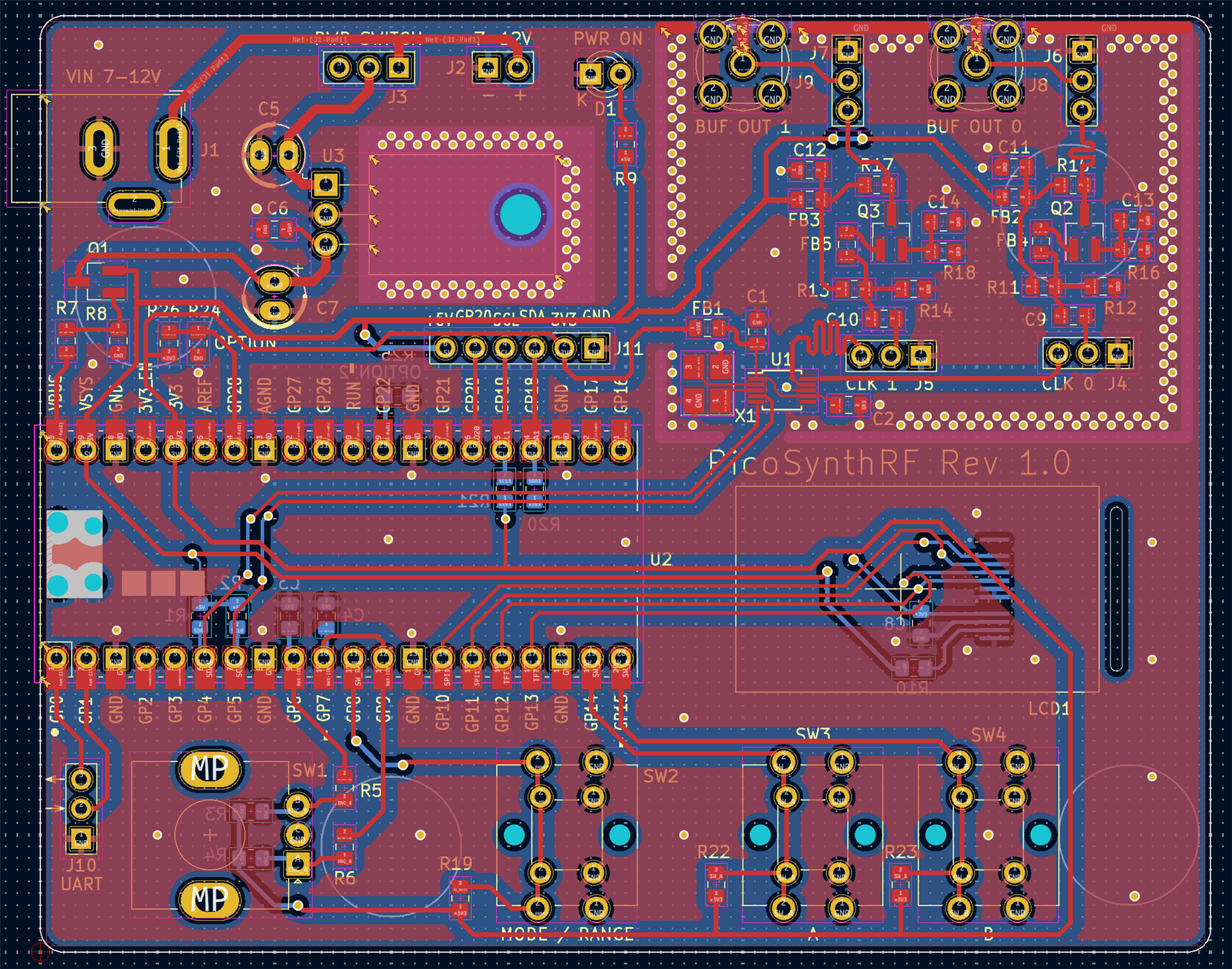

After a first pass, I had the components positioned approximately where I wanted them:
If at any point the circuit needs altering, or footprints need modifying, the procedure is to go into the Schematic editor, make the change there (e.g. double-click on a component to get to the properties and change the footprint) and then save the Schematic, and then go back to the PCB Editor, and click on the the Update PCB with changes made to the Schematic icon and then clicked Update PCB as before. EAGLE automatically did this, whereas, like a lot of PCB CAD programs, unfortunately, it is a manual step in KiCAD. Anyway, I can get used to this change in workflow.
By the end of day 4, I had manually routed a reasonable portion of the board as shown below (first pass - I have to do a second pass to do the tidying up). To do this, the most useful keypresses were X which starts off a trace and V which allows you to place a via and switch layers as you lay down traces. If you want to undo traces, press the Delete button on your keyboard. Copper pours for ground plane were easy, just select the blue Add a Filled Zone icon on the right of the screen, and when you click on a corner, it will prompt you for the net name (e.g. GND) that you wish to use for the copper pour. Once all the corners have been defined, press B to fill it in. As you route the tracks, you'll have to press B again to update the copper pours on the display.

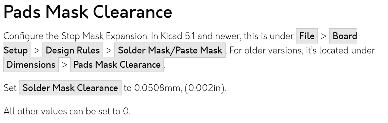

Next, I generated the Gerber files using the File->Plot menu. I followed the JLC PCB website and configured the plot menu as shown here:
Both Plot and Generate Drill Files need to be clicked. In EAGLE it is all one step. Anyway, when I clicked on Plot, ten files were generated for my 2-layer design. When Generate Drill Files was clicked, another window appeared, and it was configured as shown here:

    I generated Gerber files, and have taken screenshots from KiCAD 6 of the settings I used, in the main blog/discussion above, along with the reported information from Viewmate. It looks reasonable in the…
  • fmilburn
    fmilburn over 3 years ago in reply to shabaz +3
    That's great! I will definitely be setting 'Place->Drill/Place File Origin' in my future designs. KiCad has what they call Project Templates that allow design rules to be picked up when a new project is…

    I'm pretty much done! Ready for figuring out the Gerber file generation.
    This is the candidate layout:
