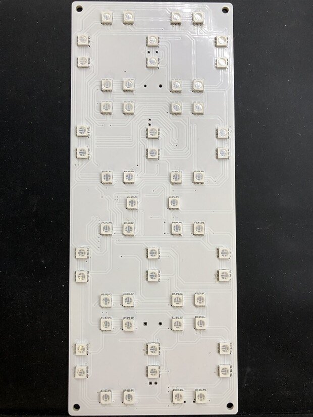

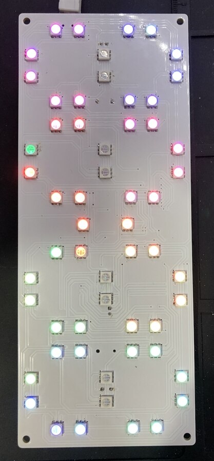

Following on from this discussion where a lot of tips came my way, I thought it only right to give it another go:  https://www.element14.com/community/thread/72152/l/first-attempt-at-smd-soldering  I really feel like I've joined the club now I burnt the end of one of my fingers image  On the plus side, none of the parts went pinging off.
In no particular order...
Following Antonio Tajeda's advice, I got hold of a DS3231 kit to have a play with - more on that later!  I did look up a 900M-T-3CM900M-T-3CM tip for my Hakko FX-888DFX-888D but couldn't find any in the UK and HK Wentworth wanted £20+ and £5 P+P for one which they'd get from Japan.  I'll keep my eye open but decided to try with the tips I had - the T18-D12T18-D12 worked very well.  I also re-watched the videos linked to on YouTube - they make it look VERY easy but I expect technique comes with practice.
Following Gene Breniman's and Luis Ortez's advice on a magnifier I have been looking at microscopes but I also tried a head magnifier in the first instance - I got one with swappable glass lenses.  The 2x was great for a bit of through hole soldering I did yesterday, and I managed pretty well on the DS3231 kit with the 3.5 magnification.  My only real issue was having to get so close to see in focus - I was around 4 inches away.  I used a PCB holder and that raised the board up so it wasn't too uncomfortable.  I think I'll persevere with that for a while and save the money.
Following Shabaz's advice I got hold of some thin solder - 0.274mm.  It was significantly easier to work with at this size than my 0.46mm.  The two sizes together are great for both through hole and SMD.  I also dropped the temperature down to 300C and had no problems - I suspect with some of the larger pads I should go a bit higher but it all worked.
There were a bunch of other tips as well, from many others who I haven't named, in respect to flux, tinning one pad first and so on - these work very well so anyone picking up on this thread could do worse than follow them.
Someone, somewhere on a different thread suggested the use of blu-tack (or similar) for through hole - it might have been Shabaz - I can confirm that it is an excellent tip!
So, here are some photos.
The LED Side

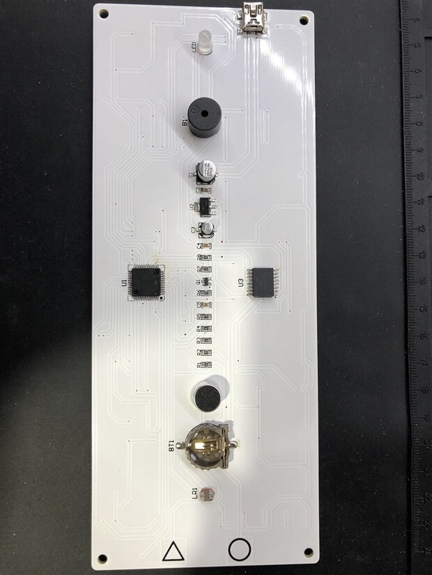

The other side - mix of SMD and through hole:

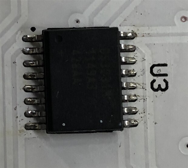

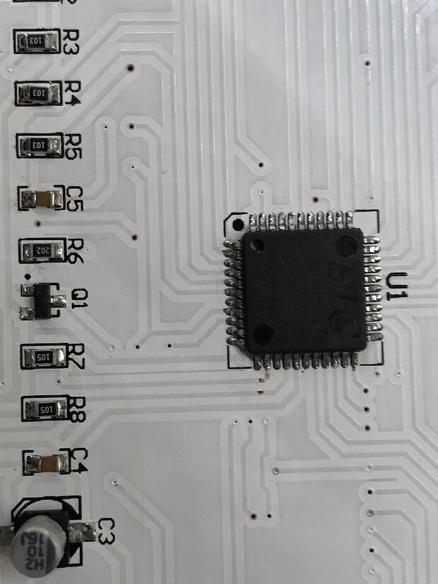

Close ups:
(I honestly thought I'd cleaned that up with IPA - couldn't see the mess by eye!)
And, finally:
As for the kit.  The PCB looks well made, exceptionally 'skiddy' surface.  However there were NO instructions with it which for the most part wasn't a problem, but placing the resistors was really an educated guess - one I got right based on everything lighting up.  There's a couple of dodgy LEDs: in the photo they are lit but will only colour blue.  Also, it isn't possible to actually set a time, date etc as the touch buttons (which I didn't have to do anything with) don't work.  As there's no schematic I can't tell if it's a soldering problem with one of the chips or just a dodgy board: there are no bridges that I can spot under my x5 magnifying glass.  Perhaps the buttons need the battery, who knows??
I think there is some scope here for Element 14 to create some quality practice kits, with instructions and troubleshooting hints.

    shabaz over 7 years ago in reply to Andrew J +6
    Hi Andrew, That's great that you're taking these precautions (many newcomers don't I bet : ). From what you say, and seeing the quality of the soldering, I bet it's 99% likely the cause is ESD-related…

    14rhb over 7 years ago
    Hi Andrew,
    That is really great work, especially the U1 and U3 components; well done. Also I'm really interested to read your comments about magnification as I too need to think about getting something but was unsure what I needed.

    Nice work. Very neat.
    I don't know about everyone else but I find that even though I'll now happily solder 0.4mm pitch LQFP and QFN, I can still make a right mess of a simple 0.1" through hole header if it suits me. image
    Hi Andrew,
    Wow, that's a world of difference. It looked like a manufactured board, it needs very close inspection to see that it is hand-soldered!

    I find LEDs amongst the hardest SMD parts, because if they are not totally square to each other, or not soldered completely flat to the board, then they visibly look wrong. That's not the case here, they look very neatly done.
    It's possible the few LEDs could have been damaged from the supplier (that's sometimes the case with bulk LEDs from ebay etc), or even ESD related stuff during their packaging, or afterwards during un-packing and soldering.

    That's great that you're taking these precautions (many newcomers don't I bet : ). From what you say, and seeing the quality of the soldering, I bet it's 99% likely the cause is ESD-related at the supplier end. To be honest when using so many LEDs (or any part) it's natural to buy spares, but kit manufacturers don't do this : (
    I recently needed 25 LED bulbs (Philips, so a decent brand) for renovating an apartment. I ordered a few spare, and glad I did, because there was one outright failure (totally dead), and a few had a visibly different colour-temperature despite coming from the same box (they were in boxes of 10). I didn't have enough spares to completely resolve that, so I had to swap them in their fixtures, until the strange colour-temperature ones were in positions where they were unnoticeable (e.g. grouping the ones in the kitchen).
