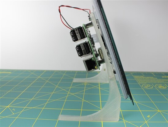

This is a light stand for the official Raspberry Pi 7"touchscreen Display. It is designed for quick prototyping as it is lightweight and takes little time to print.
  • 4 pcs M3-0.5x5mm or M3-0.5x6mm screws are needed.
At the beginning of the design I couldn't decide what was the best angle so I ended up designing 3 stands with with different angles (45, 60 and 70 degrees) -pictures attached-. Design based on the official drawing dimensions for the Raspberry Pi 7 Inch Display.

Front: 3D-printed light stand for Raspberry Pi 7" Touchscreen
Back: 7" Touchscreen Display assembled to light stand and Raspberry Pi 3
45 degrees: 45 degrees light stand for Raspberry Pi 7" Touchscreen
60 degrees: 60 degrees light stand for Raspberry Pi 7" Touchscreen
70 degrees: 70 degrees light stand for Raspberry Pi 7" Touchscreen
3 stand versions: 45, 60, 70 degrees stands side-by-side.
M3 screws: 4 pcs M3-0.5x5mm or M3-0.5x6mm screws are needed for assembly.
Stand assembly: Fastening stand to the Raspberry Pi 7" Display
Print Settings
Support: No
Brim: No
Material: PLA or ABS will work fine.
Infill: 20% or more.
Notes: Any stand you may choose, needs to be printed two times, one of them needs mirroring X or Y with the slicer app.
STL files available on Thingiverse.
