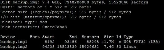

The first thing to do is to have a look at the partitions within the image file.
fdisk -lu backup.img
This will tell us what the offset for the data partition is. The SD card at its minimum has two partitions in fact, one is the boot partition and we would generally not be interested in it.
The offset is calculated by multiplying the unit size by the start sector of the partition we need to mount.
In our case the unit size is 512 bytes and the start sector is 94208 so the following command
sudo mount -t auto -o loop,offset=$((94208*512)) backup.img /mnt
will mount backup.img2 in /mnt which is generally available and free on most OS. Use another mountpoint of you need to.
Equally if you wanted to mount backup.img1 you would need to use and offset of 8192*512.
