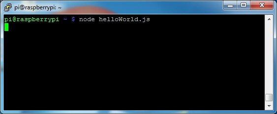

Now to test the program, copy the code into a text file called helloWorld.js and run it by doing:
node helloWorld.js
This should be pretty uneventful.  It should start up the program, but it will appear as though nothing is happening:
