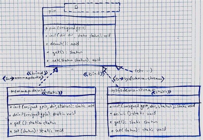

The OO API: class pin
The whole interface is a single class, named pin. It's a template class. As template type, it will accept a class that knows how to talk to the Pi.
#ifndef PIN_H_
#define PIN_H_
#include "pin.h"
namespace dgpio {
template <class D>
class pin {
public:
    enum class status : unsigned {
        off  = 0u,
        on
    enum class dir {
        in, // default for Pi
        out,
    pin(unsigned gpio) : gpio(gpio) {}
	void init(dir dir = dir::in, status status = status::off) {
			D::init(gpio, dir, status);
	void deinit() {
		D::deinit(gpio);
	status get() {
		return D::get(gpio);
	void set(status status) {
		D::set(gpio, status);
private:
	unsigned gpio;
} // namespace dgpio
#endif /* PIN_H_ */
This is everything. There is no .cpp file. All work is forwarded to the templated class.

To create a pin that uses the sysfsdevice worker, you can use a typedef:
typedef dgpio::pin<dgpio::sysfsdevice> pin;
pin p21 = pin(21);
See the example above on how you can use the pin in your code.

If you would like to use a different mechanism to control the pins (maybe via the registers?), you could develop a similar class that knows how to talk to that hardware interface.
The developer could then switch by changing the typedef:
typedef dgpio::pin<dgpio::registerdevice> pin;
pin p21 = pin(21);
(this is a theoretical example - the class registerdevice isn't developed yet) edit: I developed it in this follow-up post: C++ gpio library for Raspberry Pi - Pt 2: Plug In drivers for direct register GPIO, or file system based GPIO

    Jan Cumps over 2 years ago
    I have this working with "gpio via registers" too.
    You can choose between sysfs gpio (/sys/class/gpio) or memmapped register gpio by changing an include and a typedef in your code.
    For talking to GPIO via sysfs :
    #include "sysfsdevice.h"
    ... and via memmapped register access:
    #include "memmapdevice.h"
    typedef dgpio::pin<dgpio::memmapdevice> pin;
    For the rest the code is the same. Example:

    I'll blog the details when I have time.
    preparation for the register based driver:
    	int fdgpio=open("/dev/gpiomem",O_RDWR);
    	if (fdgpio<0) { printf("Error opening /dev/gpiomem"); return -1; }
    	unsigned int *gpio=(unsigned int *)mmap(0,4096,
    		PROT_READ+PROT_WRITE, MAP_SHARED,
    		fdgpio,0);
    	printf("mmap'd gpiomem at pointer %p\n",gpio);
    	// set pin 21 as output, by writing 001 to 5-3 of GPFSEL2
    	gpio[2] |= (1<<3); // pin 21 output
    	//	toggle pin 21
    	gpio[7] |= (1<<21); // pin 21 high
    	gpio[10] |= (1<<21); // pin 21 low
    	// Read pin 8, by accessing bit 8 of GPLEV0
    	unsigned int retval = gpio[13]&(1<<8);
    This code first set pin 21 as output, then sets it high, then low. Then it reads pin 8. All from the registers.
    See page 90 of the datasheet: https://www.raspberrypi.org/app/uploads/2012/02/BCM2835-ARM-Peripherals.pdf
    inspiration: https://www.cs.uaf.edu/2016/fall/cs301/lecture/11_09_raspberry_pi.html
    I tested, and my LED blunk.
