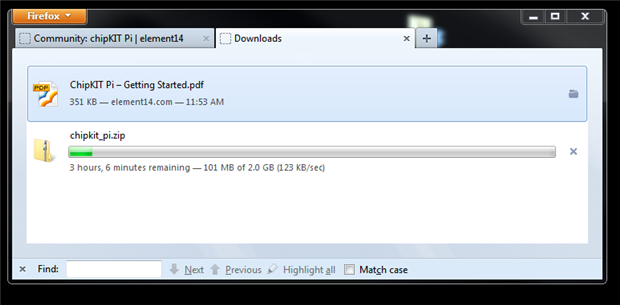

First, download the Pi NOOBS image with the MPIDE already installed on it.
http://downloads.element14.com/downloads/chipkit_pi.zip?COM=DevKitsLearningCenter

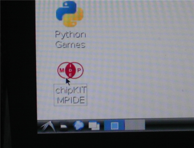

Once Raspian has loaded and displays the desktop. Click on the Chipkit MPIDE icon located in the lower left hand corner.

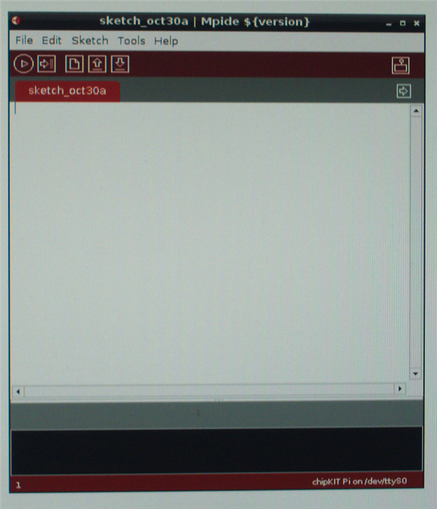

After a bit of a wait, you will see the MPIDE window.

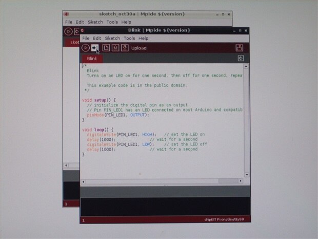

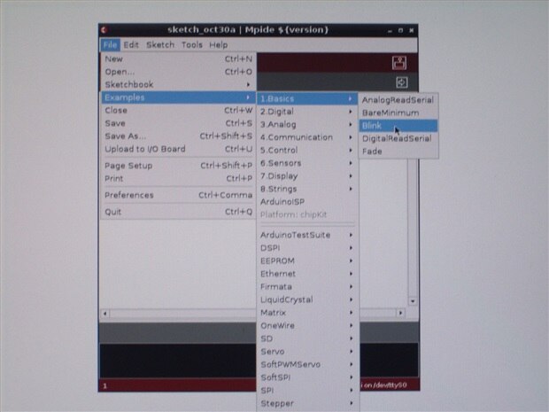

We want to upload the Arduino sketch named blink. To do this, go to File>Examples>Basics>Blink.
Click on the upload button.
The Tx1 and Rx1 LED will turn off after the Arduino sketch has been uploaded. About 64 seconds later the status bar at the bottom of the window will read "done uploading.” If you did everything right, LED1 will be blinking on and off at 0.5Hz.
I have a few criticisms though, which are not for the actual product but the infrastructure surrounding it. Starting with the three and a half hour image download time. (To be fair, that was before the recent update.)
