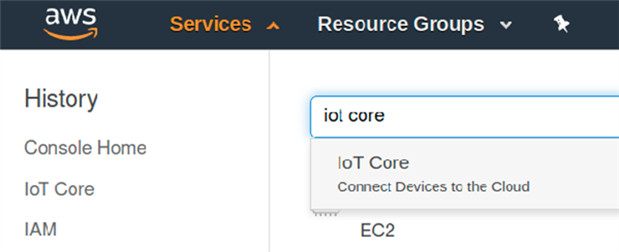

Once you’re signed in, then navigate to the “Services” dropdown and search for “IoT Core”:

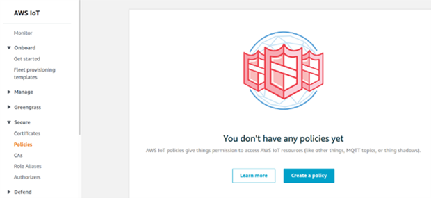

In the IoT Core console, go to Secure > Policies and click “Create a policy”:
This will allow you to create a policy that will give your IoT device permissions to act on things inside the AWS cloud (such as IoT Core MQTT Topics) that allow you to send and receive data between the device and the cloud.

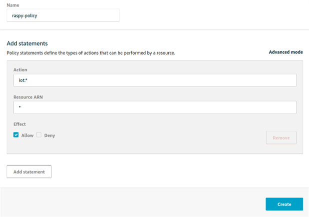

Let’s call our policy raspi-policy.
You’re going to give it some broad permissions that in a production environment we would scope down more substantially to only what the device needs. In this case though, you’re still playing around with everything and we want to be the flexibility to support any actions we might like to try. Because of this, you’ll set the Action as “iot:*” and the resource as “*” along with selecting the “Allow” checkbox.
Your screen should look like the image below:
I’ll break this down a little:
  • The Allow checkbox means that this policy will allow specific actions on AWS cloud resources. You could also set a policy that explicitly denies permissions to AWS but by default AWS denies all actions unless granted explicitly.
  • The “iot:*” action means that you are talking about ALL actions under the AWS IoT service umbrella. The asterisk indicates the “all” part here.
  • The Resource ARN indicates what specific AWS resources you can perform these IoT actions on. In this case, you’re referring to any AWS resource.
For the purposes of a device that is going to be living on your desk this might be acceptable. But you’re probably already starting to see how this policy would be too broad to be applied in a production setting. If you kept it without modification it could allow any of our devices make requests to other devices or interfere with things they shouldn’t – this is far from ideal.
For this demo though you can leave these values and the allow checkbox as shown above and press “Create”.

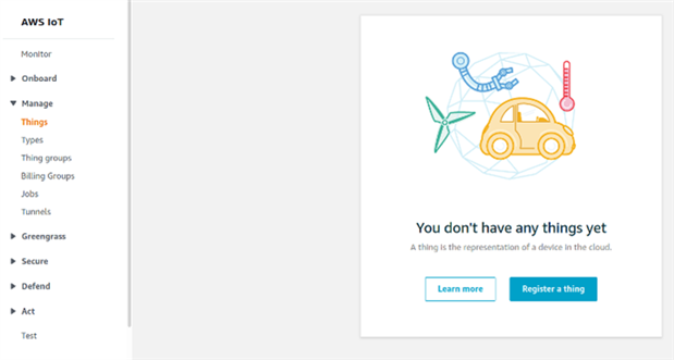

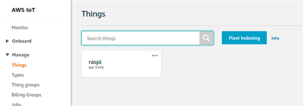

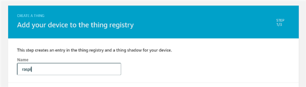

Next, go to Manage > Things and press “Register a Thing”:
AWS IoT Core provides lots of great tooling for managing IoT “Things” that can help you sort things in to “Types” or “Groups”. You can then use these settings to determine permissions these things might require and how we might want to interact with them. This can also be combined with some more appropriate permissions (as mentioned above) to help secure your IoT environments.
For right now though, you can use the easiest method of getting started and press “Create a Single Thing” and name your thing “raspi”:

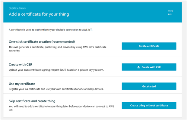

On the next page you have the option to add a certificate for your thing. This is why I suggested you log into AWS while still on the IoT device: because for the device to speak to the cloud, you’ll need the certificate on it locally.

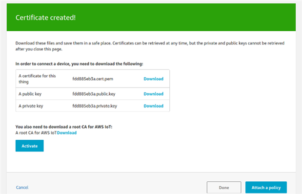

When connecting our device to AWS IoT we can use public key cryptography to do so. Within that, you have a few options for generating certificates:
Let’s see how these options work:
  • One-click certificate creation (recommended) – AWS generates a public/private key that we’ll be using for your device. It then takes the public key and makes a Certificate Signing Request or CSR that it signs with its own CA Private Key to generate a certificate we can use on our device. This all happens in the background and then AWS allows us to download the public/private key and the certificate it created for us so we can authenticate our device later on. We also download a Root CA certificate from AWS that we use to authenticate our connection with AWS.
  • Create with Certificate Signing Request – With this approach, we have our own public and private key already, either on our laptop or maybe provisioned already on our IoT device. We then use our keys to create a certificate signing request on our end before sending that CSR to AWS. AWS will then send us back a certificate which we can use in combination with our private key on the device. But like the first option, this requires us to have permissions to call AWS APIs for every new certificate we want to generate.
  • Use my Certificate – Alternatively, we can register our own certificate authority certificate so that we can sign one or many kinds of devices. Then, we can use that certificate to sign new certificate requests without having to make a request to AWS. This is the most common approach when working on production services where we are creating a large number of devices where we want to provision a unique certificate for each.
For right now, given that we’re only provisioning one device and that we’re not deploying this device into the wild beyond our home networks.
After you click this, you should download all the created certificates to your Raspberry Pi device:
Download all three of these files  and then make sure to press “Activate”. This is key because AWS has already used the public key to help generate a certificate for you, and you will mainly be using the certificate and the private key to authenticate and sign your requests to AWS.

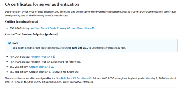

Also, on this page you need to open the link for the root CA download which is right above the “Activate/Deactivate” button:
From this page, you can download the Amazon Root CA 1. Right click the link and click “Save link as” and save it to the Raspberry Pi. This certificate will allow you to trust AWS IoT itself.
Once you’ve downloaded the Root CA certificate along with the three other certificates, you should have four total files on your Raspberry Pi. Go back to the “Certificate created!” page and make sure to press “Activate” if you haven’t already done so.

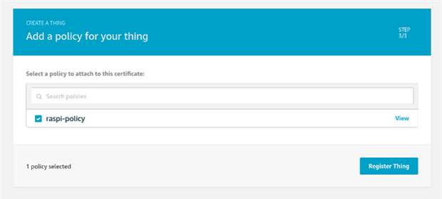

Then you can press the “Attach a policy” button. On this page, you can select the checkbox next to the “raspi-policy” we created earlier and then press “Register thing”:

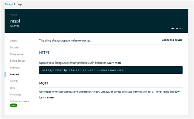

The last thing we’ll need to get before syncing our device to the cloud is the endpoint URL for our Thing. In order to find the endpoint URL you can click into the details of your new AWS IoT Thing and look under the “Interact” section. You’ll notice in this section there is an HTTPS URL and an MQTT section:
This is because AWS IoT supports connections using multiple protocols including HTTPS, MQTT and MQTT over WebSocket, for a full list you can refer to the documentation here.
On this page, copy the endpoint value under HTTPS down and use it, along with the names of the certificates you have in the present directory, to replace the “<your-certificate-name>” and “<endpoint>” sections of this command:

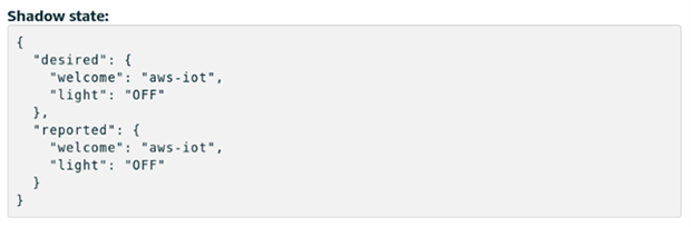

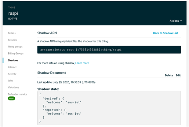

Before you run this command, go over to the “Shadows” section of your “raspi” thing and click “Classic Shadow”. You should see something like this:
Now, run the command above and see what happens on your device.
You should see an output that describes the process of syncing with AWS IoT and then a prompt that allows you to update the state of the device from the device itself.
Type in “OFF” and press enter, then see what happens to the IoT Code Shadow state:
Now, click the “Edit” option in AWS IoT Core and update your shadow by editing the “Desired” property of “light” to “ON”. You should see the device report the new updated state in the terminal!
All of this means you’ve successfully connected our device to AWS IoT Core. In the background what’s happening here is that our “shadow” here has a desired and reported value. When we update the desired value the script running on the device polls an MQTT topic provided by AWS IoT Core to see if anything has changed.
If it sees a new “desired” value then it knows it needs to update the state on the device. This triggers the script on the device to update the “reported” value in the MQTT shadow for the device. In the long run, this will allow you to act on changes to the desired or reported state of a device and manage connections between the cloud and devices more effectively, especially in situations when network access cannot be maintained – something common for many IoT devices.

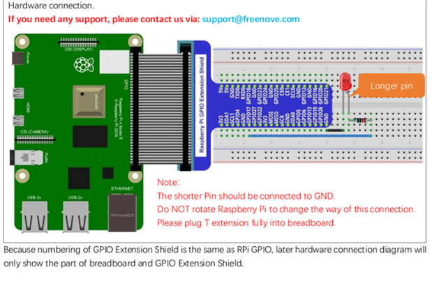

For the hardware portion of this tutorial, I’ll be remotely controlling one of the Raspberry PI’s GPIO pins in order to provide power for an LED when the “light” property of the device is set to “ON”. For right now, shutdown and unplug your Raspberry Pi so you can setup the breadboard and the LED.
I’ll be using the same pin configuration as the first project shown in the Freenove Ultimate Starter Kit for Raspberry Pi here.
You can download the project details and tutorial in PDF format from here.
Inside that ZIP file is a Tutorial.pdf file that includes the hardware configuration for the project we’re doing from page 52 to page 55 in “Chapter 1 LED”. If you haven’t done much work with hardware before, make sure that you read the instructions carefully and be sure to pick an appropriate resistor for your LED. In my case, the 10K Ohm resistor was appropriate for the red LED.
You can turn the Raspberry Pi back on after you have the breadboard configured as shown in the tutorial photo on page 55 here:

How did it go? Did you see the LED turn on and off when you ran those corresponding commands?
If not, you might have a different hardware configuration than I do. This code assumes that you’ve followed the guide above and used GPIO 17 in order to power your LED. If you’re using some other GPIO then you will need to either change the script or update your hardware configuration to make it work. Make sure to leave the device off if you need to change some of the wiring!
If this works for you, we can proceed to the next step: doing this all from the cloud!
