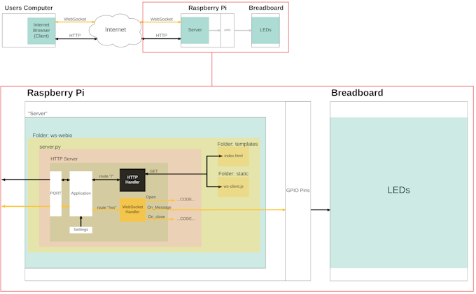

The diagram below illustrates what is happening inside "ws-webio" folder when the "server.py" application is running, and how each piece of code interacts with each other.
Server - Closer look
"server.py" comprises:
  • An HTTP Server (part of the Tornado framework). This server listens for client connections and forwards them to the core application.
  • A Tornado application. This sits inside the HTTP Server and maps given routes to "handlers" for further processing.
  • Application settings which tell the application where to find resources, such as the static files we intend to present to the web browser.
  • Handlers. This is where the magic happens: when your browser sends a request or an event, handlers are where these requests or events will be processed. In this application, the handlers are responsible for both returning the static files to the web browser upon request, and also for operating the receiving end of the WebSocket and controlling the local GPIOs.
