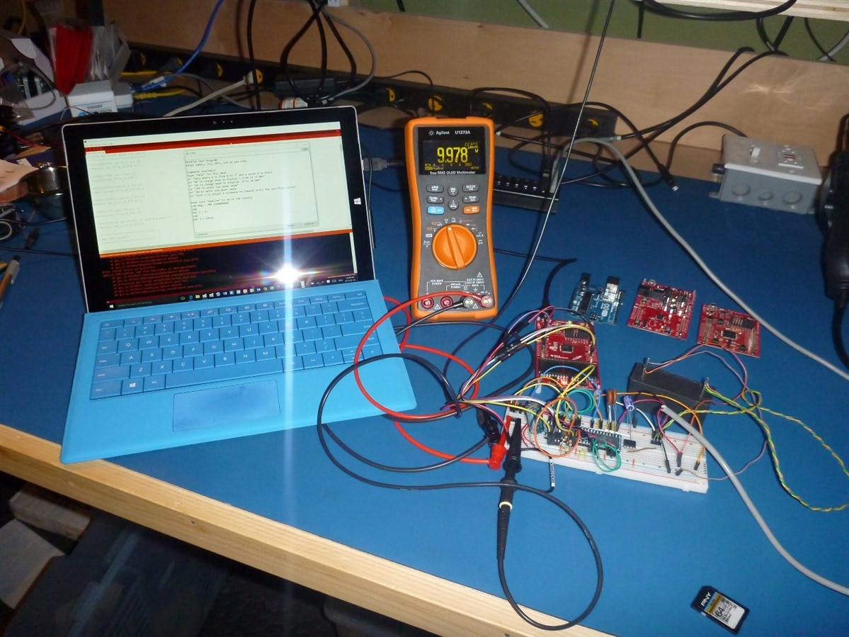

I have been working over the last few weeks on getting the DAC8734 from Texas Instruments up and running on several microcontrollers and I found there is a distinct lack of info on how to use this chip and this will effect the up coming ROAD TEST
So I have now managed to get sample code written for several microcontrollers and the Raspberry PI (Arduino UNO and Several Launch pads ) and this will be detailed in other videos and posts
I am going to create a complete tutorial video and much better screen shots over the next couple of days but wanted to share with your the initial output from the windows development environment and what it looks like on the PI screen, also I will show how simple it is to get the app running by default on the pi so you sont have to start it up via a remote console every time
This is what the app will look like when running
this is the Board under test (Connected to a launch pad here
the programs will easily work with the actual evaluation module included in the up comming ROASTEST as its interface is the same and it contains the same DAC
this is the actual eval board, the only real difference is I have only one VREF and mine is on a bread board
