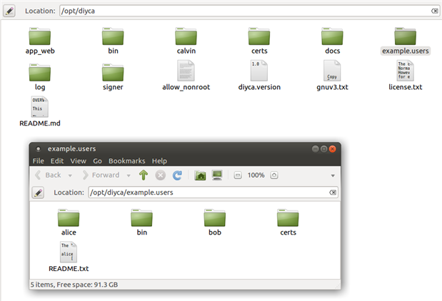

Once the `git clone` step from the preparation notes is executed, the diyca tree will look like this:
The "example.users" folders contain 2 SSL applications: alice (client) and bob (server).  A 3rd application (datagen.py in the alice folder) has been supplied to generate data that alice transmits to bob (who echoes it back verbatim).

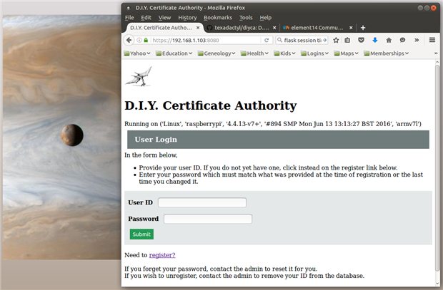

Once the diyca web server is running, it will respond to HTTPS requests at the IP address of the machine where it is running and at the configured port ("8080" is the default).  The initial screen (User Login):

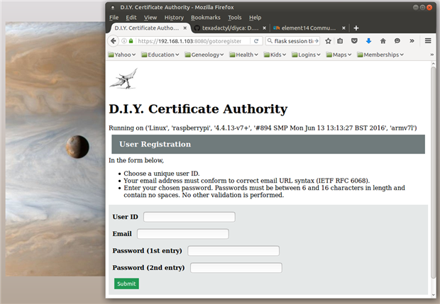

You need to register as a user before signing forms so click on the register link to obtain the register form:

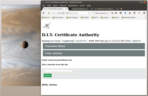

Once registered, you are automatically logged in.  The main menu appears:
depictedimage
The pull down function list gives you 3 choices:
  • Certificate Signing Request (CSR)
  • Change Password
  • Logout

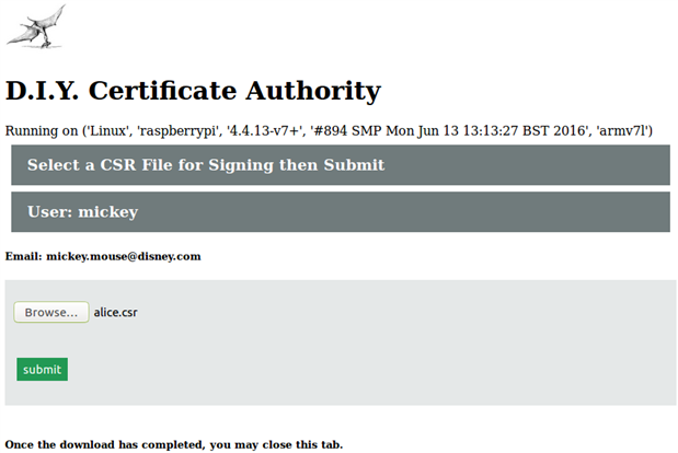

The CSR function is what alice and bob need to be able to run:
The alice.csr file has already been browsed from the example.users/certs folder on my machine.  Clicking on the submit button causes alice.csr to be uploaded to the web server, signed, and then alice.crt is downloaded.  After that, I had to move the alice.crt from $HOME/Downloads to the example.users/certs folder for the purpose of using it in executing alice.  Ditto for bob.  See README.txt in the example.users folder regarding the alice-bob duo of applications.
