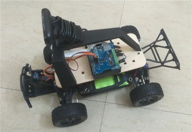

Prototype 1:

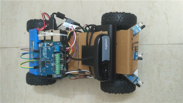

Prototype 2:

    So far I have played it manually using the custom app indoors and on smooth terrain such as tiles. Yet to do hard and challenging terrain. From the tinkering so far, the Prototype 2 using the donkey car…
