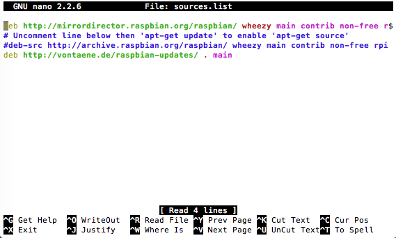

The first thing to do is adding the repository http://vontaene.de/raspbian-updates/ to the list. From the terminal launch the editor
$>sudo nano /etc/apt/sources.list
and add the following line: deb http://vontaene.de/raspbian-updates/ . main
The resulting file will show like in the image below.

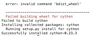

Installing and compiling the pip package manager on the Raspberry PI may require 10 minutes or more. Don't worry and wait ... During the installation you will get some error messages due the wheel command is not found; don't stop the process and ignore these messages. Wheel is a package image builder not intended for use in our case. The error message you get is shown in the image below.
Cythonhttp://cython.org/ is the c-extension for python and is used by some components of kivy. For a detailed description see the cython wiky.
At the end of the process described above cython should be installed in your system. We use the pip repository to acquire the last updated version, avoiding the eventually outdated version available in the Debian packages.
sudo pip install cython
