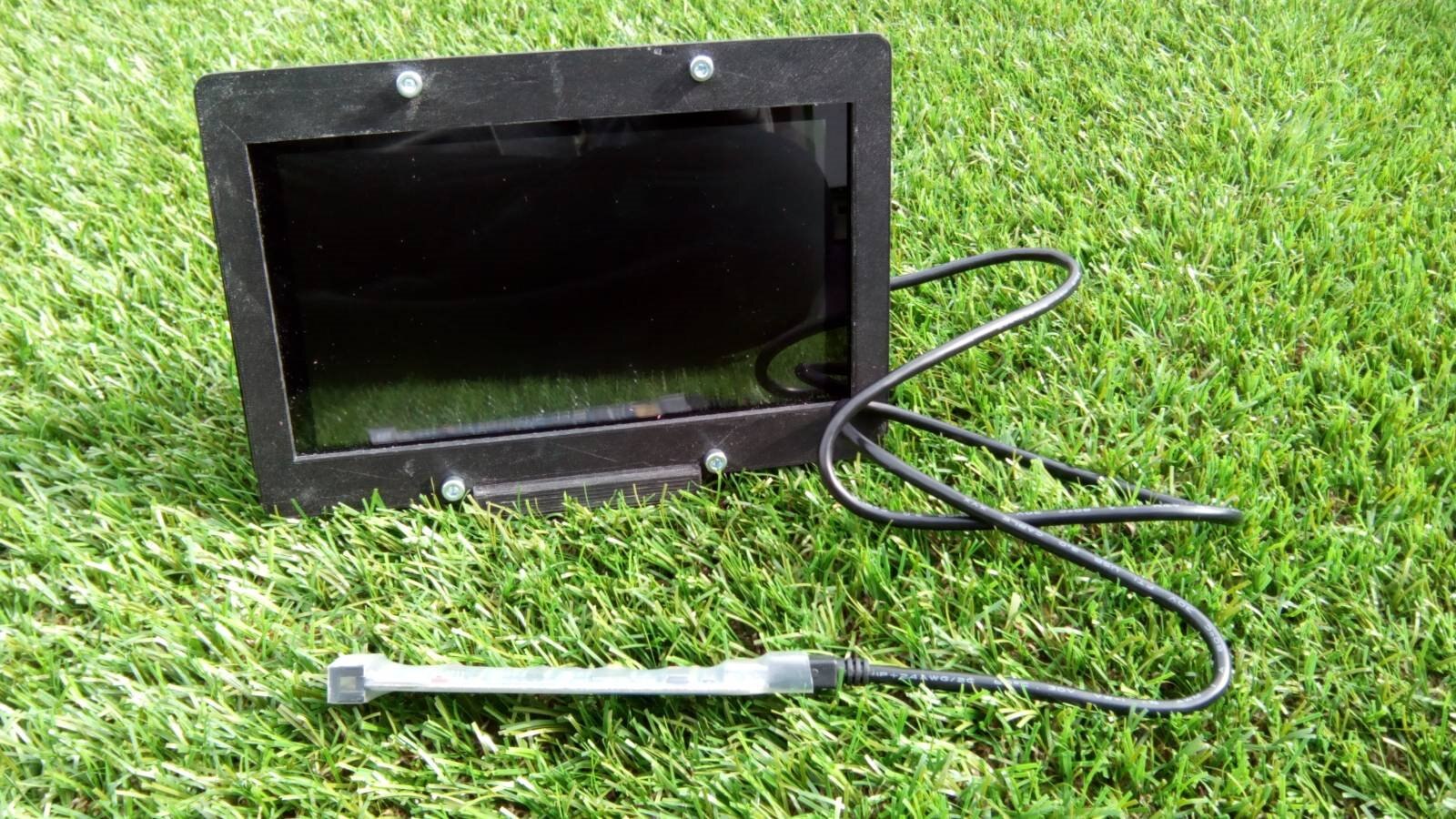

  • Bitscope micro has a form-factor useful for usage as a probe with status LEDs that should remain exposed for the best use
  • The touch screen should be easily accessible and visible while the oscilloscope probe can be easily used nearby to the tested parts
  • The Raspberry PI ports should be easily accessible, for some kind of usages also while the oscilloscope is connected (e.g. an external keyboard)

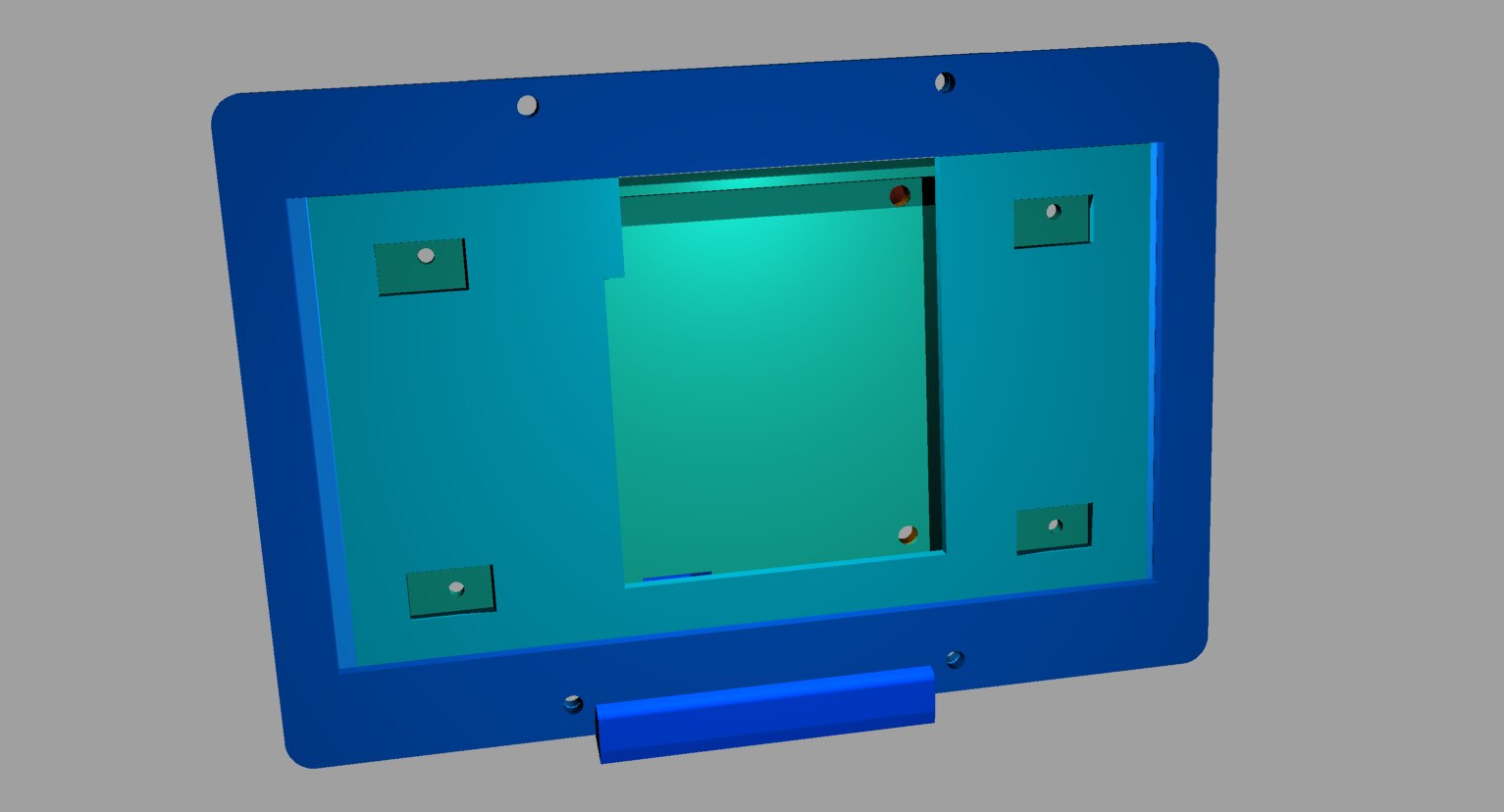

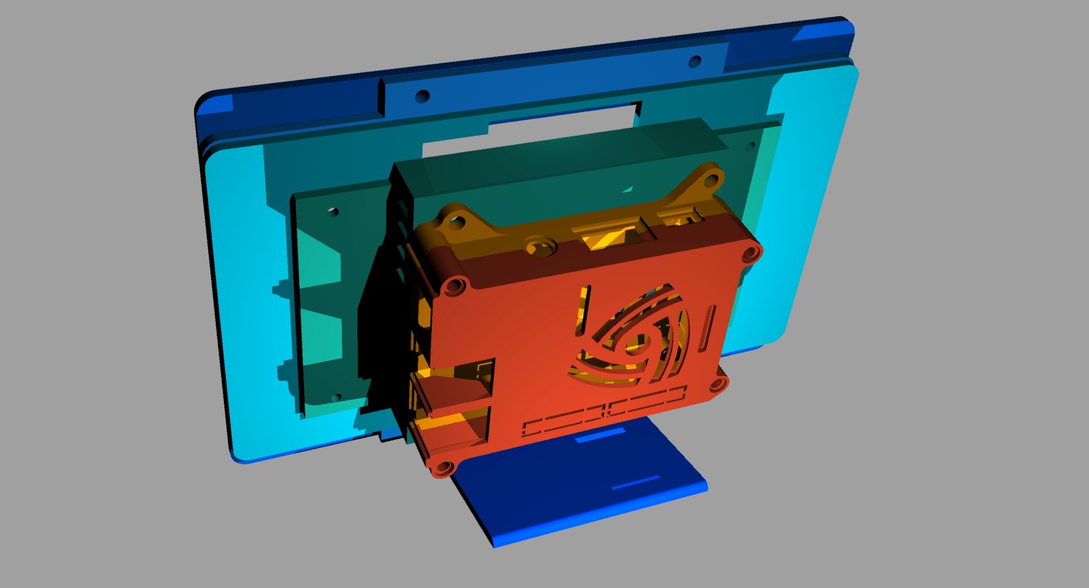

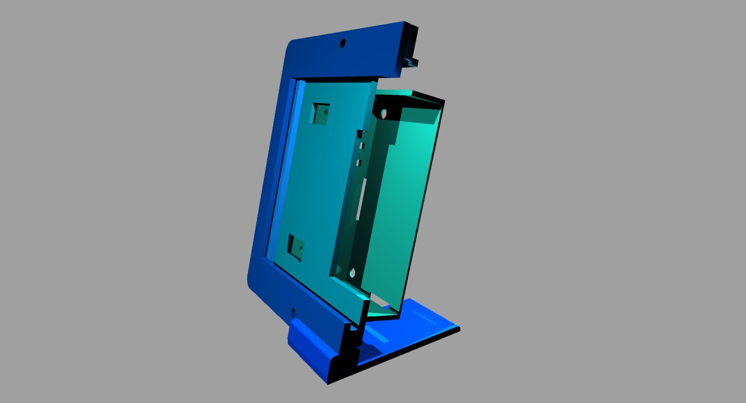

The 3D model
The images below shows the assembled model of the components (the stl files are available in attach to this article).
The front view of the model
The back view of the model
The section view of the parts

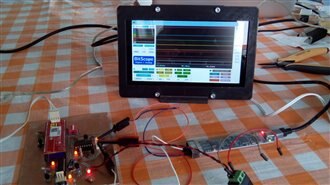

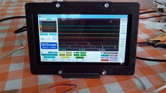

Pi-Scope in use
The following short video shows the Pi-Scope usage while testing the state of a stepper motor PWM signals
