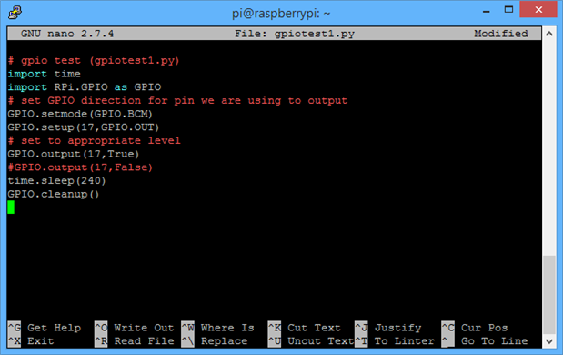

Here's the Python code I used. It's sitting in the Nano editor on the Pi, as viewed remotely via Putty. It just sets the output of GPIO17 either high or low and waits for 4 minutes before ending. I could have done more with it but there wasn't any point.

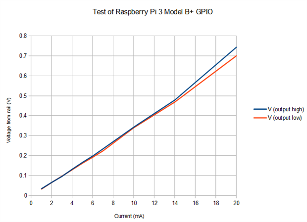

Here's the graph I got.
The voltage is the difference from the respective rail, so is approximately the voltage dropped by the internal MOSFET. Keep in mind that, as an experiment, this is very 'rough and ready'. The slope of the line [voltage over current] is a resistance, roughly speaking the rds(on) of the MOSFET. At lower currents, that's looking like about 30 Ohms. It goes off a bit at higher currents [how real that is is perhaps open to question - it was getting hard to adjust the current accurately by that stage - but we might also surmise that local heating of what is a fairly small transistor is changing the rds(on) value].

    Actually, there is an LED in the background of the picture (the power light), but it doesn't form part of the experiment. In case it wasn't very clear to anyone (I might have done it better if I had put in a bit more explanation), the experiment is measuring each of the internal pair of complementary MOSFETs that make up the pin driver, inside the processor, to see how they behave. Not too surprisingly, they behave like MOSFETs do.
    Knowing the rds(on) might be useful if you wanted to drive a series-terminated length of microline on a board. If the line were 50R, you'd need to add about 18R or 22R to pad the MOSFET figure to the 50R.
    Other than that, just keep in mind that the output voltage will move away from the rail as you take more current from it.
