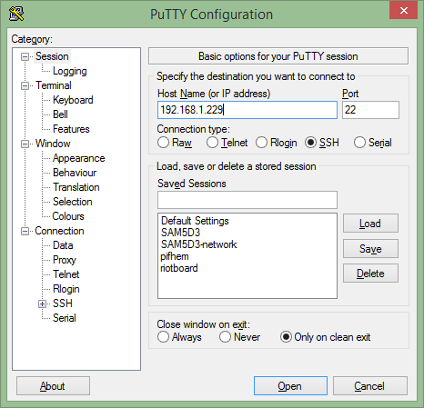

Seems a few folks are having an issue logging into the PI B / B+ using SSH and may be following misleading instructions so I just compiled a set of screen shots showing the process for mine, this has not had anything specific to enable SSH, so it should work with  any new install using the Debean (Raspbian) distro
Step one, load "Putty", if you don't have it then google putty, download it and install
now enter the IP address of the PI, you should be able to find this out from your house router, this is my record:

or enter the name "raspberrypi" , either should work,
