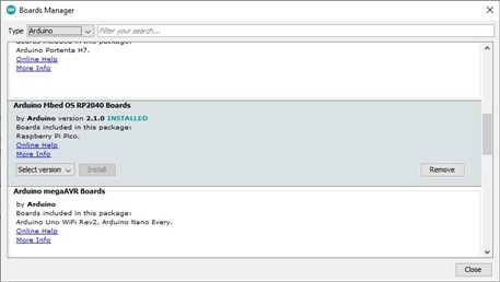

Earlier this week, I spotted that Arduino had updated their ArduinoCore-mbed Boards Manager files for Arduino Mbed OS RP2040 Boards to version 2.1.0.
The exciting part of this update is that it includes the pico-sdk multicore library, which I have been eager to try out for some time now.
Unfortunately for Arduino fans, there is no ready-made Arduino multicore examples available on the Arduino IDE. Instead you have to go to the Raspberry Pi Github page and grab the multicore C examples from their pico-examples repository.
At the time of writing this blog, there were 4 multicore examples listed on Github.
Unfortunately, I found that when inserting these examples into an Arduino sketch, not all compiled as-is via the Arduino IDE.
I also found that none of these code examples were designed to run continuously on the RPI Pico, as in, there was no repeated multicore data exchange within a while(true) function or the sketch's loop() function. This made it more difficult for me to work out how the runtime interaction between the two cores actually worked as the examples were all one off events.
Thankfully I've made progress and solved a few issues myself, which I now want to share with others.
