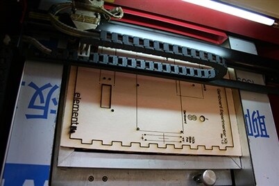

Nonetheless, by 1 pm the next day I had the drawing ready to go. Then I looked up the laser cutter. Ah, a problem. I’d given the components lots of space so that the kit would be easy to put together. The LS3020 from HPC Laser Ltd turned out to have a roughly A4 cutting area. A hasty resizing took place to fit the design into this space.
Next, we would need to get hold of the wood. I figured that plywood would be a good medium. We chose it over acrylic for the way it looks when it is burned by the laser and because it was more readily available. The only acceptable thickness I could track down at 3 pm on Sunday afternoon that would fit in my car was 6 mm. Seemed a bit thick for a laser cutter, but hey, I’d seen that it could cut up to 8 mm so I invested. I’d never been to a hackerspace before Sunday, so it was interesting to finally see the one in Leeds. Angus and my brother Bob sacrificed their Sunday afternoons to set up the laser cutter and after a couple of test cuts is sliced with buttery ease through the ply. Success! By the evening we had a prototype. Most of the holes seemed to be in the right place. However, it had taken nearly 4 hours to get the first box cut, so the design would have to be modified. The cutting was pretty quick, but the etching of text and logos took an age.

There was only one thing for it. We would need to optimise our production process. The next evening in the Hackerspace we aimed to produce all of the boards we would need. Disaster struck. For some reason, the laser wasn’t cutting through the 6 mm ply. The lens seemed clean, the alignment wasn’t too bad. We upped the power. More smoke, more flames, but still the cut didn’t reach all the way through. We slowed the cutting speed right down. Again, the same result. Each successive cut was more and more difficult to “persuade” out of its frame. By 1:30 am we had about 10 front plates cut. They had no labelling. They were splintering at the back. The blackened areas were becoming more and more pronounced. All the guys from Leeds Hackerspace tried to help. They were massively generous with their time, but still we couldn’t figure out what was wrong. Was it the wood? Was it the cutter? In the end, we decided to try and spray paint the front labels for the board to avoid the long time that it took to etch, which could have looked cool, but turned out ...not very well. The paint bled under the stencil so we needed to find a better, faster solution! There was an off-chance, said one of the guys, that we could call a business in Keighley called Fab Lab and ask to use their bigger laser cutter.
The next morning, I got on the phone to Fab Lab and asked them whether they could help us with our cutting problem. They were amazing and agreed to let us use their machine from 1 pm that day. We got hold of some 3.6 mm plywood from Woodworks Timber Ltd to err on the side of caution. They were super quick at turning around 40 sheets, cut to size. It wasn’t a big order, but they really helped us out. Another swift redesign was in order to shorten the “turrets” from 6 to 3.6 mm. Whilst Vicky and Pat (who work on the element14 website) did the final assembly on the actuators, Paul and I headed off to Keighley. It should be mentioned here that Stu and Iro (our social media and marketing friends) helped to screw all the Raspberry Pis and Gertboards to the mounting plates. Unfortunately, we had to reverse their hard work later on!
We didn’t know what to expect from Fab Lab and I was starting wonder whether we would be able to build the kits on time. In spite of the sleep deprivation and few costly wrong moves, the decision to call Fab Lab was a very good one. Dave, of Fab Lab, helped us to cut an initial prototype (v1.1). Everything fitted together. It looked great. A couple of tweaks to cut the text at low power rather than etch each word. Now we were cooking on gas.
In three hours we had turned out 16 perfectly cut sets which just needed assembly. The thinner ply was a little more prone to bowing, but it didn’t seem to make much difference in the cutter.

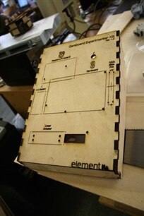

Wednesday evening was spent gluing the boxes together with Paul, Mike and Chris. We wood glued the turrets and then held each box together with tape to counter any bowing. We also mounted the Raspberry Pis and Gertboards to the front plates and did some of the initial soldering to lay the groundwork for the epic task that would be Thursday’s assembly. By 9:30 pm we had finished and it was time for a much needed curry.image
