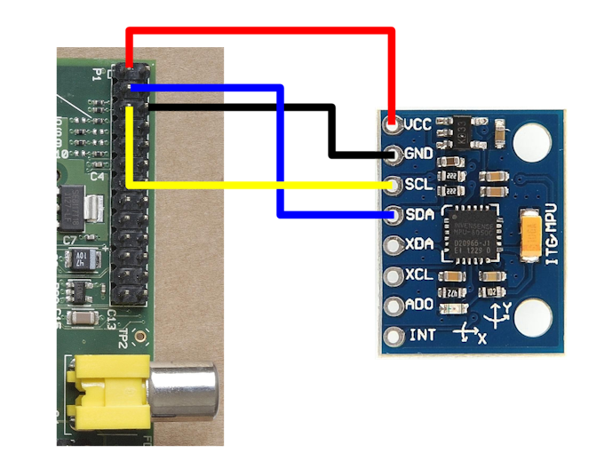

Electronics Setup:
Electronics Setup
  • Connect all pins of accelerometer & GPIO properly follow links for tutorial.
  • Stuff About ADXL345 Accelerometer & Python
