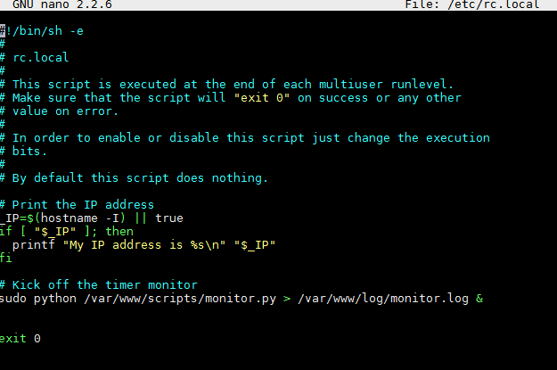

In order to have a continuous process I wrote a script that runs 'for ever' and then defined it in /etc/rc.local as shown below. If this file (i.e. rc.local) doesn't exist you can create it in the /etc directory - it will get processed every time the Pi is booted up, Make sure you give it appropriate permissions if its not already there (e.g. sudo chmod 777 /etc/rc.local)
My rc.local file looks like this. Note the call to run the script is sudo python <script_name> - don't forget to put sudo in or the file wont get run because of permission issues. I'm piping output to a file so that I can keep an eye on what its doing.
