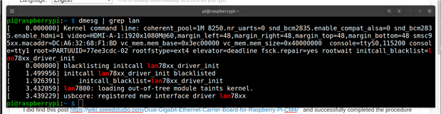

Does anyone have any insight into lan78xx usb driver support for the Raspberry Pi?
I am attempting to use a Microchip PoE USB-C device to enabling networking to a Raspberry Pi4B. The work is part of a RoadTest for Microchip PoE to USB-CRegistered Power and Data Adapter .
A quick check with a command line lsmod shows no lan78xx driver. There is no /lib/modules/5.10.17-v7l+/kernel/net/usb to support the lan78xx as suggested in some posts I have found.
I did find this post https://wiki.seeedstudio.com/Dual-Gigabit-Ethernet-Carrier-Board-for-Raspberry-Pi-CM4/   and successfully completed the procedure for an Ethernet Port configuration.
A lan7800 module reference does appear for a command line lsmod after the install. The Microchip PoE USB-C lan7800 port is not detected when connected to the Pi. Still no reference to a lan78xx module appears in the directory structure.
The vendors site https://www.microchip.com/wwwproducts/en/LAN7800  indicates there has been support in the Linux kernel. My searches for Pi driver support has been limited. My understanding is lan78xx is a modules in the usb subdirectory when installed. I'm not seeing that for this kludge.
I'm thinking maybe I need a a dtsoverlay in the config.txt directory. Really not sure. I have gone as far as to load Ubuntu for the Pi to see if it is O/S related. That didn't prove fruitful.
I welcome any insight community members may have regarding network driver installs for the Pi. I will continue to hunt and peck to see if there is anything I have missed.

    Are you powering the PiZeroW via the Microchip PoE-USB-C adapter? What adapters/cables are you using? Perhaps they do not connect or somehow mangle the D+/D- lines?
    Unfortunately, I gave away my PiZeroW, so I don't have the hardware to test with. Perhaps you should try adding just dtoverlay=dwc2 to config.txt in case the Pi Zero W's older SoC's OTG controller isn't supported by the xHCI driver. Perhaps test without any overlays, then with the dtoverlay=dwc2 and then otg_mode=1, looking at the lsusb and dmesg output on each.

    Gough Lui over 5 years ago in reply to colporteur
    In fact, it wasn't as hard as you think for me to discover the solution. It really only took me 10 minutes from start to finish to get my Pi 4 up and running on the Microchip PoE USB-C adapter. It's probably down to my way of breaking down the problem into steps and the fact I am somewhat familiar with Linux and device driver issues (eugh).
    My methodology was:
    • Get it powered. Plug in the PoE adapter, get the orange power light to come up - that was no difficulty at all as it should just work. Plug in the USB-C to USB-C cable, get the Pi to start booting. I hit a snag here precisely because my version of Raspberry Pi 4 (being an earlier unit) has a CC pin issue which means the PoE adapter cannot sense what sort of device it is connected to, so will not supply power. You were successful in getting yours to work because it is likely to be a later unit that corrected this error. For me, using a USB-C OTG to USB-A adapter provided the PoE adapter with the right CC resistances to start sourcing power, then using a regular USB-A cable to USB-C to hook up the Pi to the adapter provided the path for the power and data, overcoming the issue.
    • Get it detected. Because my Pi 4 was "dual-connected", I could still reach it via WLAN/onboard Ethernet while the PoE adapter hadn't come up. I suspect the PoE adapter was not detected purely because the green DATA LED on the adapter was not lit or blinking - this is a "feature" of the unit to tell you if the USB connection is established. This was verified with a quick lsusb to determine USB devices connected - remember, even if there are no drivers, lsusb will show connected device details. This pointed at no USB connection existing - so I looked up how to enable the USB-OTG port on the Pi 4. Similarly to you, I came across many articles about USB gadgets and the dwc2 driver, but I ignored them because all those articles are about turning the Pi into a "device" pretending to be a USB to Ethernet adapter. What we needed was to turn the Pi into a "host" so a device (the PoE adapter) could connect. That post was part of a thread that was first or second in my search results list and mentioned xHCI (where HCI stands for HOST Controller Interface), yet another hint. I made the change and it came up.
    • Check for drivers. Now that it is detected, does it function? Thankfully, yes - so I didn't have to go any further, but I suspected it would be. The reason is that the LAN7800 in this product is a descendant of the LAN7500 and the LAN9500, both previously used on-board the Raspberry Pi. The release notes for the Windows drivers support ARM as well and mention that their drivers were derived from the LAN7500/9500 drivers, suggesting there is a lot of similarity in the code, so I suspected that drivers would already have been readied and in the distribution.
    It is important to note that because the USB-C OTG functionality of the Pi 4 uses the USB 2.0 hardware, the throughput on the Pi 4 when attached to a network in this way is about 340-380Mbit/s just like older Raspberry Pis with Gigabit USB Ethernet soldered onboard (e.g. Pi 3B+). The throughput using the physical on-board port is higher, as it has a dedicated Gigabit MAC on the Pi 4.
