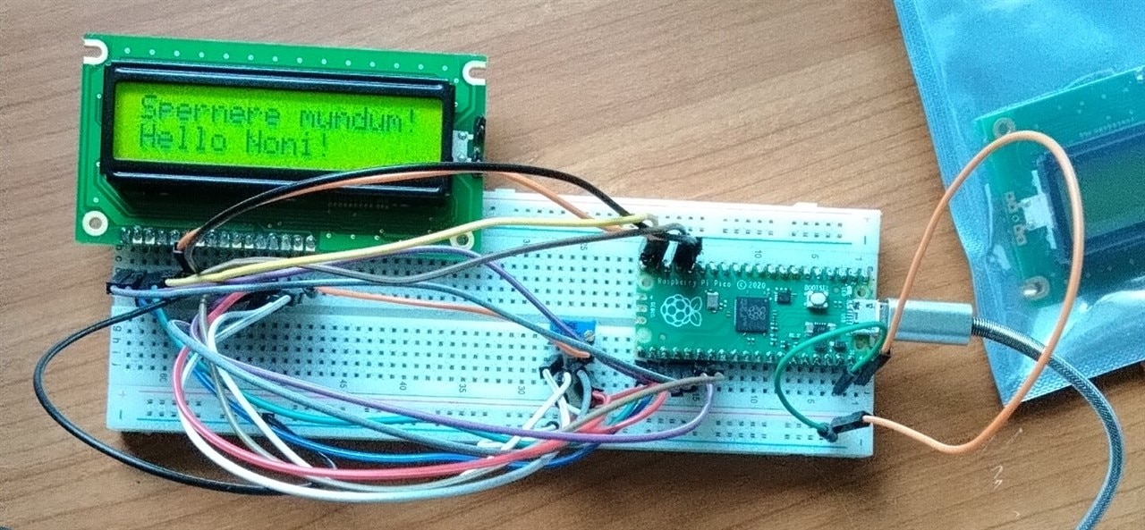

In this blog, I demonstrate how to use Raspberry Pi Pico’s Programmable IO (PIO) interface to drive an LCD module using either the 8-bit and 4-bit parallel data bus.
In this demo project I started with an FDCC0802B 8x2 LCD module (shown above) as I had one and I had modified it before to fit on my breadboard. Of course, a 16x2 LCD module would work equally as well here too.
I then progressed onto a 20x4 OLED Display (NHD-0420DZW-AY5) from Newhaven Displays, which also can be driven using the same driver firmware although I found it was not perfect and probably would need a few tweaks.
The reason behind this project was to help me learn more about the PIO interface than anything else. I am also sticking with C/C++ and I used the Arduino IDE and associated libraries to develop the project.
My LCD module controllers
So to start, here are the key specifications for the two LCD modules I used in this project.
Fordata FDCC0802B (8x2 LCD)
source: Fordata on-line LCD Module catalogue ( V6.0 )
According to the Fordata Electronic Co. COB(Chip On Board) SERIES on-line catalogue ( V6.0 ), the LCD module is controlled internally by the Sunplus SPLC780D LCD Controller (or equivalent). This controller is also compatible with the Hitatchi HD44780 driver, which can be found on many text-based LCDs.
Thus this LCD module is pin compatible and has a similar pin configuration, which can be broken down as follows:

The NHD 20x4 character OLED display module is pin compatible with a standard 16x2 or 8x2 LCD module and similarly the same driver commands will also work. It is worth noting that there are some timing differences in terms of the internal processor "busy periods", which may or may not impact display performance. I did have to slow timings down a bit.
Pico Programmable Input Output (PIO)
I decided to start with the Arduino’s LiquidCrystal library as this library was developed for the Hitatchi HD44780 driver and is available for all Arduino compatible boards and is compatible with the above LCD modules I was planning to use.
After a review of the Arduino LiquidCrystal library and the datasheets I knew that in order to get the Pico’s PIO to drive all or parts of the LCD module, I had to mimic the LCD controller instruction sequence and bus timings to successfully write to the LCD module to display data.
source: Waveshare's LCD1602.pdf
Having reviewed a couple of different datasheets, it appears that they all have the following sequence characteristics with some minor minimal nanosecond timing differences, namely:
  • When the Register Select (RS) signal is set then there needs to be a minimum delay (tsu1) before the Enable signal can be changed from LOW to HIGH. In the above diagram the minimum delay time is 100ns.
  • The Enable pulse high signal has a minimal time it needs to stay high, which in the above diagram is shown as tw. The high signal needs to be at least 300ns long.
  • The Enable signal can only be pulsed again (shown in diagram as the cycle time (tc) after at least 500ns. Some driver datasheets have a minimum cycle time of 1000ns (1us).
  • The data sent to the 8 pin data bus (DB0-DB7) has to remain set for at least 80ns (a derive value, made up of tsu2 + tf + th2).
Based on the above diagram, I figured that there was probably no point getting the PIO to drive the RS signal as this only changes once to indicate if the data about to be sent is a command or is data to be displayed. But this needed further evaluation.
The HD44780 driver datasheet also provided a timing diagram for 4-bit mode operation, which informed me that the 1st (IR4-IR7) and 2nd (IR0-IR3) nibbles of data could be pulsed quickly before the busy read flag (BF) was set and then cleared.
The part that was unclear in the above diagram was the duration of internal operation, when the busy flag was set. Thankfully all the datasheets I reviewed provided timing guidance within an instruction table. Thus execution times depended on what commands were sent. For example, a Clear Display command would typically take up to 2ms to execute, while a Display ON/OFF Control command would typically take about 40us to complete.
So after a bit of thought, I decided to use PIO for the data bus as I could shift data in parallel using the PIO OUT command and I would use the PIO SET for the Enable signal as this was timing critical during operation.
Thus in my project, the R/W signal will be tied to ground as I am not checking the busy flag and I would then set the RS signal outside of the PIO using a GPIO to tell the LCD whether I am sending a command or writing data.
To get the PIO code started I began with the 8 bit mode as this transferred all data at once.

The above PIO instruction sequence can be broken down into 4 steps:
  • It waits for data (PULL).
  • It shifts data to the 8 output pins (OUT Pins, 8).
  • It latches the data by setting the Enable pin high (SET pins, 1) and then low (SET pins, 0) with a specific timing sequence.
  • It pushes the Input Shift Register (PUSH), which has a dummy value, so say sequence is complete - this is to ensure that the next byte of data does not arrive too early.
With 4 bit mode I could make some improvement to the Arduino code as I could send 8 bits of data at once and then get the PIO to repeat the 4 bit pattern twice by shifting the MSB nibble (4 bits) of data first and then the LSB nibble of data. As the HD44780 driver datasheet 4-bit timing diagram showed, the delay between the two nibbles is shorter. So in this case I used the Y Scratch Register to create a repeat sequence in the PIO code.

This module works in either 8 bit mode or 4 bit mode. Here is the 8-bit mode in operation.

Newhaven Display NHD-0420DZW-AY5 (20x4 LCD)
The same cannot be said with this module. Whilst the NHD OLED module is pin compatible and the same LiquidCrystal library works (successfully tested using Arduino UNO), I simply could not get anything displayed on the screen.
Talk about frustration. I kept thinking there was something wrong with my code, but it turned out to be a power problem and once I had reduced the voltage a fraction, it worked.
As I don’t have a variable desktop power supply, I decided to improvise by using different dev boards as my power source. Here are the results of my power source experiments:
  • Raspberry Pi Pico USB Vbus pin: V5.13 (Does not work).
  • Raspberry Pi Pico USB Vbus pin through diode: V4.3 (works although row text issue more common - see below).
  • Arduino Duemilanove Vin pin: V4.56 (works).
  • Arduino Duemilanove 5V pin: V5.08 (Does not work).
  • FRDM-KL25Z Vin pin: V4.70 (works).
  • FRDM-KL25Z 5V pin: V5.06 (works)
So I determined that the voltage drop across Vss and Vdd could range from 4.3V up to 5.06V. I also discovered that I could operate this module at below the recommended voltage of 4.8V although I suspect (can’t say for certain) that voltage causes the quirk described below.
Yes, there was still one thing that was perplexing. For some reason the rows of text displayed often get jumbled. So for example row 1 text is displayed in row 2, and vice versa, and row 3 text is displayed in row 4, and vice versa. The problem is that it is not consistent. So every now and then it switches back to normal.
The other quirk that I have not sorted is creating and displaying customer characters correctly. But I am sure this can be resolved by digging deeper into the datasheet. It was something I observed but did not investigate further.
Other than these quirks, it almost works seamlessly.
