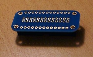

Hardware Assembly: Pi Cobbler
Before we start with any configuration on the software side, let's put the Pi Cobber together. The set comes in four parts: the ribbon cable which carries the signals from the Pi, the adapter, a PCB and a row of 2.54 mm headers.
You should be able to see on the blue PCB that the footprint of the adapter has been outlined, this makes it easy to get the adapter the right way round. Slot the adapter through the central holes in the PCB so that the writing on the PCB will face upwards once it's soldered. The notch in the footprint should line up with the notch in the adapter.
Now solder it on. If you are inexperienced with soldering then it's worth checking out the tutorial videos that Gert Van Loo made which should help.
Once you have completed that, cut the 2.54 mm headers to size and then slot them into the holes in the PCB so that the long legs are on the opposite side to the PCB writing. Adafruit recommend that you can keep the whole thing steady by first pushing the headers into a breadboard. Gert suggests another way, which is to use a sponge to hold the components in place. Either way works fine. Solder the pins and then make sure you test them. An easy way of doing this is to use a multimeter with a beeper which sounds when there is a short circuit.

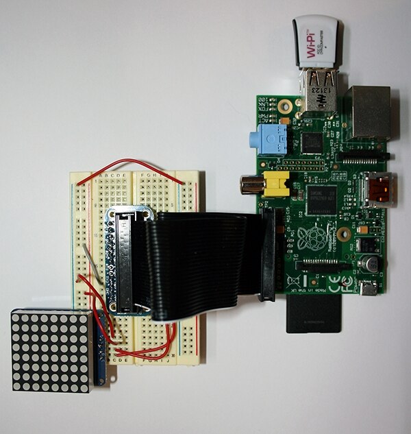

Now that you have the soldering done, fit the ribbon cable into the adapter. The notch on the ribbon cable with fit into the notch in the adapter so that you know you have it the right way round. Notice that there will be a coloured (or white) stripe on the ribbon cable. This has to be the right way round when connected to the Raspberry Pi so be sure that it lines up with pins 1 and 2 on the Pi.
Hardware Assembly: 8x8 LED Matrix & Backpack
Depending on the type of matrix you have bought, it is wise to follow Adafruit's assembly tutorial to ensure that you orientate the LED matrix correctly. It is square so can easily be soldered in back to front. Like the Pi Cobbler, there is a little soldering required, but nothing too tricky. The 8x8 matrix uses a constant current controller IC which means you don't have to dedicate a large number of IO pins to controlling the LEDs (like you would if you just expanded your Hello World! program). All you need to do is to use the I2C line from the Raspberry Pi.

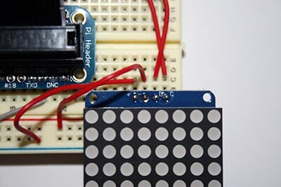

Wiring it up
I2C only needs simple connections, which is why it is so popular. It uses a Serial Data Line (SDA) and Serial Clock Line (SCL), which can be found at pins 1-03 and 1-05 on the Raspberry Pi. It also uses a ground and 3.3V connection for power. If you look closely at the LED matrix, you can see that the 4 connection pins are marked +, -, D and C. The SDA pin on the Raspberry Pi needs to be connected to the pin marked "D", and the SCL pin needs to be connected to the one marked "C". The "+" symbol needs to be connected to 3.3V and the "-" symbol needs to be connected to ground. The Raspberry Pi has 5 GND pins to choose from so pick one and wire it up. You can find a diagram to help explain these connections here, but is useful to figure out what goes where from looking at the PCBs. This will help later on when you have to wire up more complex circuits.

sudo python ex_8x8_pixels.py
If everything has worked as expected, you should see the LED matrix light up in a scrolling sequence. Well done! If not don't worry, in electronics, things rarely work the first time, so go back through the steps and test to see what might be wrong. Most of the time it is a spelling error, or simple mis-wiring.
To exit the program hit ctrl-z. This just breaks out of the program so the LEDs will remain lit in whatever their last state was, so the scrolling will freeze.
