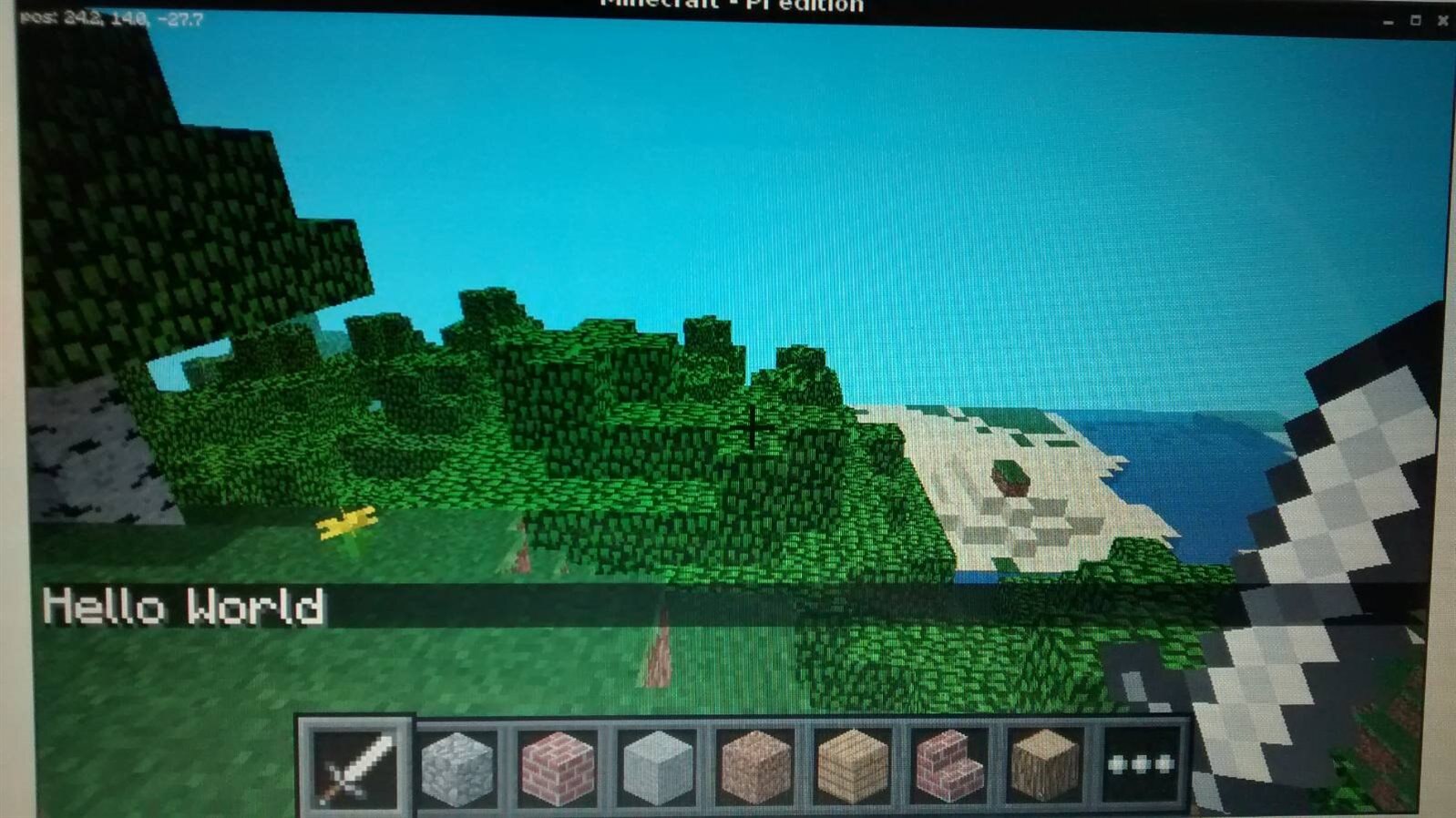

Our final line of code simply calls the postToChat function and we pass if the string “Hello World”, not very original but a great test to make sure that everything is working.
To run your code, firstly you will need to save it, and to do this click on File >> Save. Save it to your home directory and give the file a name, but please do not save it as minecraft.py or Minecraft.py as this may cause issues in future.
With your project saved click on Run >> Run Module and then quickly switch back to the desktop with Minecraft using the desktop switcher icon.
You should see this on the screen.

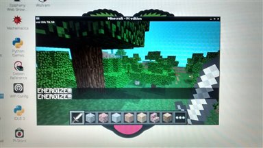

Post to chat “Energize” because I am a Star Trek geek.
Wait for 5 seconds and then the process repeats.

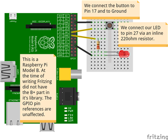

Type this code into IDLE and save the file. Now we will build a simple circuit using the hardware components. Connect up the components as per the diagram.
When your wiring is complete, run the project in idle via Run >> Run Module and then quickly swap back to Minecraft using the desktop switcher. When ready press the button on your breadboard.
Steve will be teleported to a new location on the map, if he gets stuck press the button again.

Our first addition is setting up pin 27 as an output, we will attach an LED to this pin later in the project.
When the button is triggered the LED will light up.
The LED will now turn off.
Now we will build a simple circuit using the rest of the hardware components. Connect up the components as per the diagram.
Steve will be teleported around the Minecraft world and the LED on your breadboard will light up.
