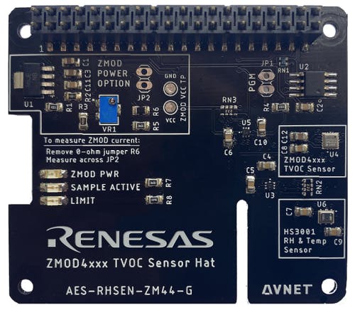

Thankfully, I just happened to have Avnet's ZMOD4410 Indoor Air quality Pi Hat sitting on my desk.
What does the Indoor Air Quality Pi Hat measure?
The Renesas ZMOD4410 measures total volatile organic compounds (TVOCs or VOCs) to produce an Indoor Air Quality (IAQ) measurement.

Plug the included header extender into the Indoor Air Quality Hat. Plug the Hat onto your Raspberry Pi.

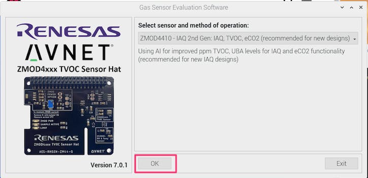

It’ll start up in a few seconds and you'll see the GUI.
  • The first screen will ask you to select your sensor and method of operation. I chose the IAQ Gen 2 firmware, since it's currently the latest and it's recommended.

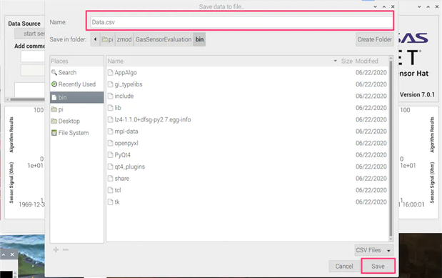

  • It will ask to verify where to save data. I chose the default - Data.csv under pi/zmod/GasSensorEvaluation/bin. Note that if you would like to visualize old measurements, you can simply load them by selecting "load data file" (next to start sensor)

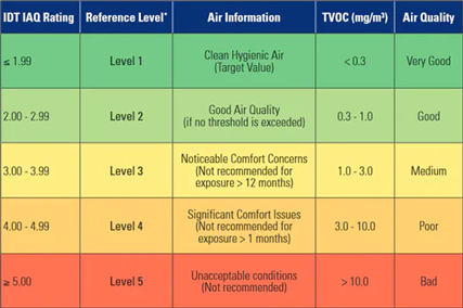

My indoor air quality is not as bad as I thought it would be! Indoor Air Quality was measured around 1, which is "Clean Hygienic Air" according to IDT/Renesas's scale (there is no international scale for IAQ, so IDT developed their own based on different TVOC and IAQ standards). You can see the best air quality is measured between around 8pm and 8am, when I had the sensor in my bedroom. When I brought it back downstairs this morning you can see that there's a jump in CO2 and TVOCs:
I suspect that this jump in TVOCs is caused by my desk. I varnished it in February, so it is probably still off-gassing formaldehyde.
I was thankful to see that my CO2 levels were estimated around 400ppm, which is excellent - it's equivalent to normal outdoor CO2 level. It jumped just above 500ppm around 10am this morning. Still, there's no cause for alarm here as anything under 700 is acceptable.image
