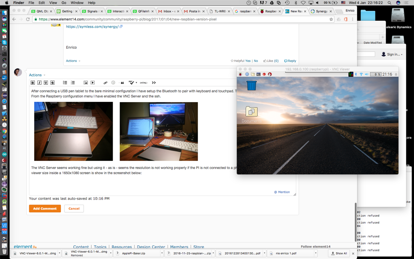

  • beacon_dave
    beacon_dave over 9 years ago in reply to balearicdynamics
    Sounds like the video defaults to a 'safe' low resolution if it doesn't detect EDID info on the HDMI I2C bus and VNC defaults to that low resolution.
    Looks like you can manually force the video resolution in the /boot/config.txt file which might fix it.

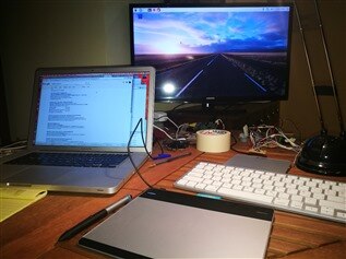

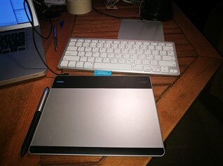

    balearicdynamics over 9 years ago
    After connecting a USB pen tablet to the bare minimal configuration I have setup the Bluetooth to pair with keyboard and touchpad. Then the system worked decently. From the Raspberry configuration menu I have enabled the VNC Server and the ssh.
    The VNC Server seems working fine but using it - as is - seems the resolution is not working properly if the PI is not connected to a physical hdmi screen. The resulting viewer size inside a 1650x1080 screen is show in the screenshot below:
