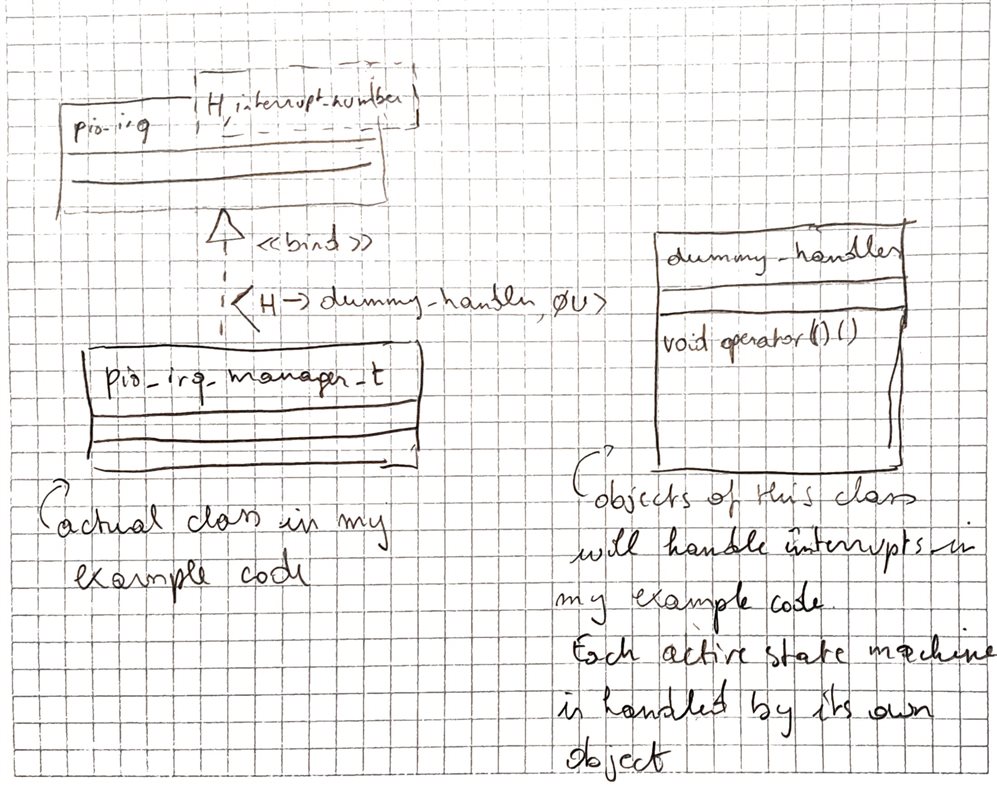

Define the interrupt manager for your design
Easy :). We just need to create a type that knows what handler type and what interrupt number we're servicing.
using pio_irq_manager_t = pio_irq::pio_irq<handler_t, IRQ_NUM>;
That's really all there is to it. You don't have to (in fact: can't) create an object of this class. You can directly use it.

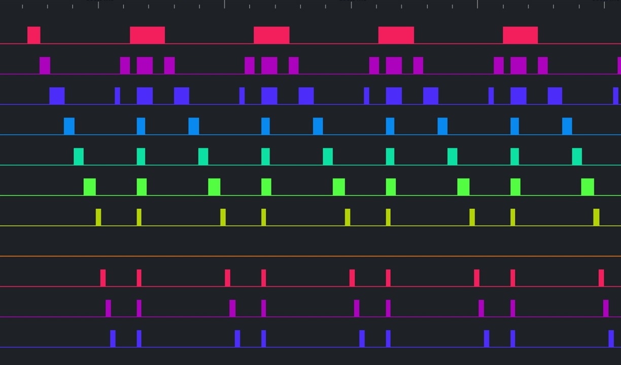

As soon as the SMs are enabled and the handlers registered, the mechanism is active. You can see a snippet of the output here.
Each registered object gets called when its state machine fired interrupt 0. And executes the code of operator()().In this little, that is: increase counter, print message:
