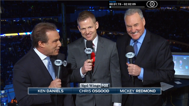

Having used the Raspberry Pi model B for a few years now I can feel a bit of a speed boost on the new Pi 2.  The main menus are comparable between the two but where the new Pi jumps ahead is the sub-menus inside the apps.  This is probably due to the fact that the Pi is doing some scraping or processing work to generate these sub-menus inside the apps that I'm using.  The faster processor handles this better.  Based on my small experience with the new Pi I would say this time is almost cut in half.  On the old model B it would take 5 seconds or so to load the sub-menus in NHL Gamecenter while now it's only taking around 2.  That might not seem like much but when you have to navigate down through a few sub-menus it starts to add up.
Video playback on both Pi models is great.  I can play 5000 kbit/s streams of my NHL Gamecenter games with no problems.  When I get my server set up in my new house I'll be able to add that as a source and play the files off of it too.  I also like the AirPlay feature.  I don't use it a lot because it can be hit or miss.  I think that is a WiFi issue though.  My setup used to have the Pi on a wireless bridge so streaming a YouTube video to the Pi took 3 times the wireless bandwidth.  (Once to get it from the router to the iPad, once from the iPad back to the router, and once from the router to the Pi.)  The Chromecast is smarter about this.  (It just passes the URL to the device and let's it get it on its own.)  I imagine if you were streaming from a wired device or a video that you have on your device already it would work well.  Streaming music from my iPad works well though.

Menu overlays on video without any performance hit
