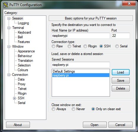

I used a 61 watt hour laptop battery pack to drive a Rev 1 Pi model B, with a WiPi dongle. With the camera active at 30 second intervals and the dongle unplugged I got around 30 hours of battery life, a couple hours less with Wifi active. I logged in using SSH and looked at the pictures via a SAMBA share of the Pi home directory to check the camera was aimed correctly.
To set the timelapse going I used the nohup command to keep the python script going after logoff, and appended an & to the end of the command to allow me to continue typing other commands into the console:
