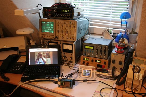

In my project I connect a digital picture frame (DPF with hacked firmware) to one USB connector and display the picture from the camera module with local time, date and weather information getting from an RSS weather feed. Every 30 seconds a serially numbered picture is saved with the same information in it. Every 200 pictures I generate a timelapse video from the photos with avconv. But this is not all, you can also watch the last picture and if you wish the last video in a webbrowser from everywhere.
Here you can see my den (I cleaned up a bit before taken the photos, the photo was taken with my Canon EOS, the oscilloscope show the signal on a local DS18B20 - the source for local temperature).
The camera module is mounted on a Adafruit Prototyping Pi Plate:
Photo taken with camera module and presented in webbrowser:

    thank you - that is not so difficult. On the raspberry runs a php-script. I get the picture with the raspistill command and insert text in the picture with imagettftext function (you have to install the GD Library with sudo apt-get install php5-gd). Then convert in one jpeg file with imagejpeg. This file is displayed in the webbrowser.
    I could send you the php script, if you have problems.
