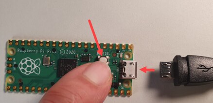

The version/variant of Python that is installed on the Pi Pico can be changed at any time by also drag-and-dropping the Python firmware binary file onto the USB storage drive letter, but this time do it by first holding down the button that is on the Pi Pico, before plugging in the Pi Pico to the PC, and then release the button.

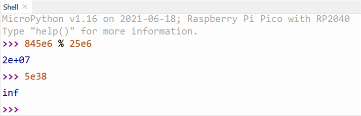

Unfortunately, the mathematic capabilities are quite limited with the Python variants available, which are CircuitPython and MicroPython. The pre-built ready-to-download CircuitPython and MicroPython firmware images are both configured for single-precision calculations. It is very easy for mathematics-related discrepancies to appear when using single-precision.
Here's an example with a downloaded (from the raspberrypi.com website) MicroPython image.
As can be seen from the screenshot above, very large numbers such as 5 x 10^38 cannot be represented properly.

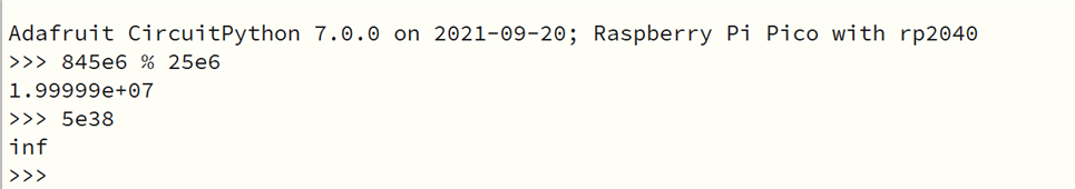

The situation with CircuitPython is actually currently worse. The screenshot below shows the inaccuracy when calculating the remainder when dividing two large numbers. To be clear, these numbers are not very large in the engineering world. 845 x 10^6 happens to represent a phase locked loop (PLL) frequency, and 25 x 10^6 represents a cheap 25 MHz crystal.
From my perspective it's crippling having no sensible way to have double-precision in these Python variants; furthermore the maths capabilities ought to be a unique selling point of Python : )

That firmware.uf2 file can be renamed to something sensible, and then uploaded to the Pi Pico in the normal manner (i.e. hold down the button that is on the Pi Pico, and plug the USB connector to the PC, release the button, and then drag the .uf2 file to the USB file storage drive letter that appears.

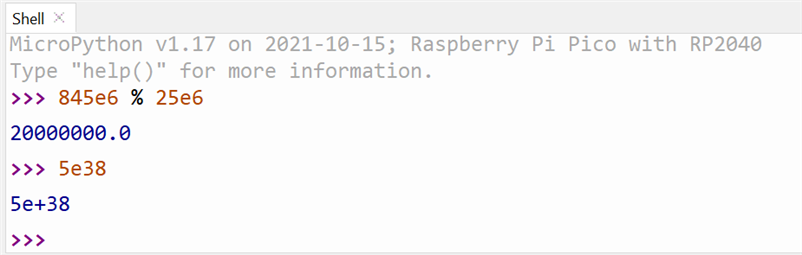

Example Double Precision Output
Sticking with the same example as above, here is what appeared for me with the double-precision version of firmware:

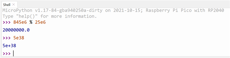

With the latest snapshot version as of 25th October 2021, this is the output:
