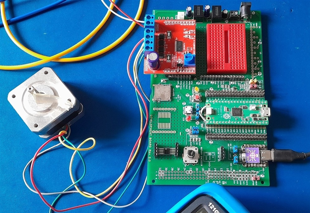

The Pico has a set of PIO co-processors. They are real-time controllers that can execute logic with deterministic timing. Ideal to run strict-timed sequences and state machines. And to implement extra peripherals (like a quadrature decoder here).
The PIO engine is not easy to program, not easy to learn. But there are some great examples out there. I'm reviewing Sub-Step Quadrature Encoder from SDK pico-examples.
In this post: test the example, using the rotary encoder on shabaz' PICO-EUROCARD
This is an interesting case. Most quadrature decoder examples (such as this one) count steps per time. Works great in many cases, but has its issues. This one takes a different approach. It calculates the time per step, and derives speed from that.
The code uses a PIO state machine to read the encoder's activity and translate it into the info we need.
Adapt to PICO-EUROCARD rotary encoder
The Raspberry Pico code uses pin 10 and 11 as rotary encoder pins A and B. On the eurocard, the controller is attached to pins 6 and 7. In the example you have to change 1 line of code:
 int main(void)
     substep_state_t state;
     // base pin to connect the A phase of the encoder. the B phase must be
     // connected to the next pin
     // const uint PIN_A = 10;
     const uint PIN_A = 6;
That's it :). Build and test.
Testing
To test this, you just need to connect a terminal program to the debugger. Then wiggle the encoder ...
An alternative decoding solution that fits when the common technique isn't granular enough.
Thank you for reading.

    Stepper motor time. I found an example to control a stepper via  PIO. I want to try that out first, then see if I can make it do ramp-up ramp-down.
    Jan Cumps over 1 year ago
    The design has a calibration function.
    Suggestion is to create test code that runs the motor stable at 50%, then call that function. It will then return the phase sizes of the encoder.
    These values can then be used in the real firmware to have optimal coverage over the whole speed range.
