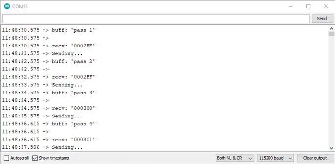

Time to try using the Arduino-Pico library to program the RPi Pico using the Arduino IDE.
I thought it would be good to try the NeoPixel Ring that I had previously tested using MicroPython Happy Pico Pi Day .
But first I am going to use one of the included examples to verify that I got the installation correct.  I am using the TalkingToMyself example that uses both I2C interfaces, have one master and one slave and send data both ways between them.
Pretty simple test.  The master just sends a string "pass #" with # incrementing each iteration and the slave responds with an incrementing hex number.

And it all works as expected.

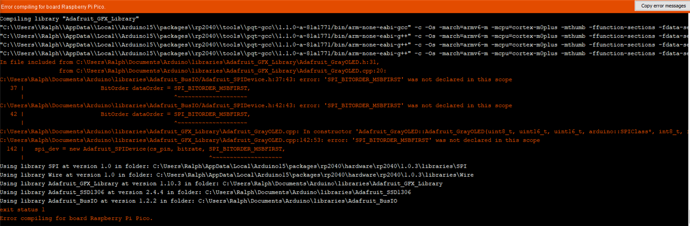

Now to try the NeoPixel library from Adafruit.  Unfortunately, this was a failure.  It compiled and uploaded, but the nothing happened with the NeoPixel ring.  I put a scope probe on the output pin and it never toggled.  I suspect there is some definition missing in the library required to set up the NeoPixel timing for the RP2040.  I'm sure that Adafruit will get this working...
I saw a video clip from Adafruit on Tom's Hardware that showed their new QT Py 2040 running with a SSD1306 I2C OLED display using the Arduino-Pico library https://youtu.be/sfC1msqXX0I .  I tried the GFX demo for the SSD1306, but that gave me a compile failure.
I was surprised that I was getting a SPI related error when I was attempting to use I2C, but I couldn't figure how to make it go away.

So, that begged the question - is my NeoPixel library up-to-date?  And it wasn't.  Now my NeoPixel demo is working...

So, I guess the moral of the story is that you should keep your libraries up to date.  Of course, in some cases this will cause older programs not to compile.
