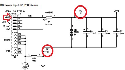

The PI micro USB power connector
This connector is ONLY used to provide power to the PI, it cannot be used to transfer data
The diagram below shows that the power from the wall adapter (Direction of the Arrow) goes into the micro USB connector (VBUS - VIN) and then through an 1100mA fuse (F3 in the diagram).

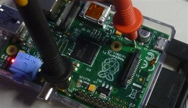

Also note in the diagram “TP1” and “TP2”, this is the test points on the PI circuit board used to measure the voltage level on the board. When connecting a test meter to these pins it should read +5V0 (5 Volts) as indicated on the label top right of the diagram. We will use these pins later when we run some real tests.
Regulators that supply the PI internal circuits and the GPIO devices (If any)
If you don’t understand the diagram, don’t worry, the description should be enough for you to understand what is happening.

The 3v3 regulator (top) feeds (From pin 3) all the internal circuits and the GPIO connector as well as supplying the 2V5 (middle) and 1V8 (bottom) regulators, this 3V3 regulator must be supplied with power that is at least 1.2V above the output power which works out to be 4.5V (3.3V + 1.2V). This means that if the input power goes lower than 4.5V the output of the 3v3 regulator can start to go unstable affecting the Ethernet and other parts of the PI. Oh and a note to a few people that provide advice on the various forums, there is NO 5V regulator on the PI, it relies on the wall adapter for this.
USB Output connectors
In earlier PI revisions, there used to be fuses just before the USB connectors limiting the output power to connected devices, this was causing many issues with users who connected anything other than the simplest of devices, as a result the makers of the PI removed them thereby limiting the total power protection to the first fuse mentioned above (F3). You will note that the same +5V0 label from the above diagrams is also on the top left of this diagram. They are all connected together meaning the only thing between the devices connected to the output USB and the input USB power adapter is the F3 fuse.
Don’t be fooled into thinking you can happily connect devices to the GPIO and USB ports that add up to 1100mA (Including the power the PI takes), you can’t. The rating of this fuse is the point at which it will “Blow”, the sustainable current is only 700mA above which the fuse will start heating and increasing its resistance causing the power on the other side to slowly fail and eventually the PI will reset or start behaving erratically, this could be minutes or even hours after the initial power up.
This is not a permanent problem, the fuse is resettable and if disconnected from power for a while it will heal itself and start to allow power to flow correctly again. It may take several hours or even days to fully recover which means if you use the PI too soon after blowing it may not work correctly even if you now unplug those extra devices. You need to give the fuse time to heal.

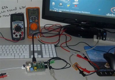

Test Setup
In order to be able to measure the power being drawn through the USB cable, I will have to cut into the wires carrying the power, rather than damage the test wires I have modified one of my older but good quality extender cables. It contains thicker wires for the power than most modern cables and therefor will have little impact on the results and in addition I shortened it considerably.
In order to simplify the connections, I completely cut the extender cable, soldered the ends onto a breadboard either side of pin headers so I can add jumpers to create a pass through or remove one or more to be able to perform measurements, in addition I added a very low value resistor (0.010Ω) to allow measuring the mA flowing through the wires. This will have little effect on the measurements, I could have used the meter to measure the mA directly but this would have also added several feet of addition wire.
You can see in the pictures below the results of this as well as the markings on the outside of the cable indicating the gauge of the wires within, later you will see how much thicker the actual wire is compared to the test cables.
Homemade made break out cable
Black jumper is removed to measure mA flow. I will use the 30mV range on meter due the use of the 0.01Ω resistor, this will give me 10mV per 1000mA flowing
Overall test environment
Keyboard, Mouse (Plugged into the Keyboard), WIFI module, HDMI connected screen, breakout cable connected at the power adapter end of the USB cable under test, Agilent U1272A (Orange) 4 1/2 digit meter and my old but trusty Master Craft (Grey) 3 1/2 digit meter
The orange meter was connected across the terminals on the break out board where the black jumper was installed in the previous pictures, this will monitor the mA flowing but still allow me to disconnect the meter for other measurements without shutting down the PI, the master craft meter was used to measure the voltage across TP1 and TP2 on the PI board itself.

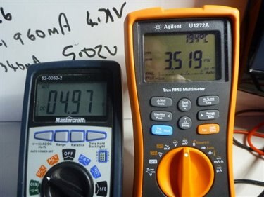

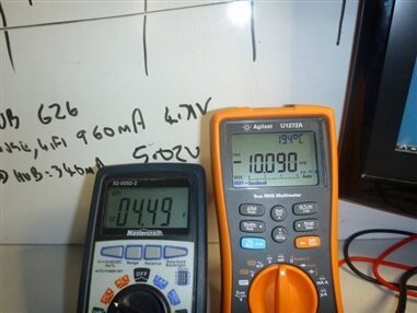

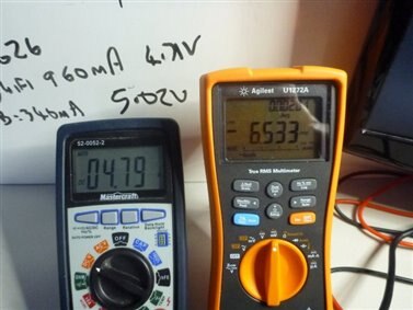

The actual test procedure is simple, connect each USB lead in turn, power up the PI and wait for it to boot up, measure the current and the voltage at the breakout board and the voltage across TP1 and TP2, rinse and repeat for each cable noting the readings as I go, subtracting the two voltage readings gives me the drop across the length of the test cable. When I calculated the resistance in ohms per foot, I doubled the length of the cable as it contains two wires involved with powering the PI, one for the positive supply coming from the power adapter and one for the ground going back to the adapter.
Note the PI in the diagram above is rotated 180deg from earlier pictures as it was easier to measure this way during testing.
Below are a few sample shots of the meter readings during testing
Waiting for the PI to boot up and for the readings to average over more than 200 samples
With cable 2 and the WIFI, Keyboard and Mouse attached, the PI would not boot sucessfully, it would start, get so far and reset, this cycle would keep repeating so in order to test the cable I removed all but the HDMI output and repeated the test. This is why the lower mA reading (The reading is in mV so multiply by 100 to get the mA (Remember the 0.01ohm resistor)

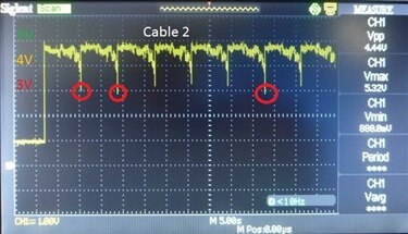

OK, so we have rated the test cables and found good and really bad ones, great, but what is actually happening on the PI board to make things go bad, well I hooked up my oscilloscope to let you see…

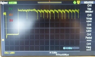

The best cable (3) shows the power go straight to 5V and after about 20seconds settles down, the worst spikes dipping down to 4.25V probably as components are powered up during boot.
The worst cable (2) clearly has a problem, the PI cannot even boot, it keeps getting so far and then resets and tries again, you can clearly see where the 5V supply dips below 3V, once I’m done with this test, the cable is going in the trash, bin for you Brits J… I’m one too so no worries, I’m not having a dig.
Sorry about the glare on this one. I think this was cable 5, either way it did allow the PI to boot and seemed to work ok, but you can clearly see even here the volts during boot up dip well below the recommended operating volts for a 5V device (4.75 – 5.25V). If I ever started to get problems, it could easily be this cable and I discovered later that when I plugged in and out the WIFI module it sometimes rebooted the PI, this never happened with cable 3.

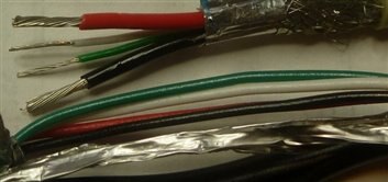

Time to dissect cable 2.

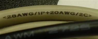

So cable 2 clearly claims to be 28AWG as can be seen in this photo of its markings

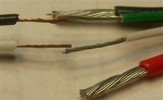

After carefully stripping the outer layers to reveal the inner cables, they look to be thicker than the signal wires from my breakout cable but much smaller than the power wires (which is correct as the power wires are 20AWG and the signal wires 28AWG) The test cable is the lower in the right diagram, the upper is an off cut from my breakout cable for reference.
Now were getting somewhere, I stripped the wires to reveal that the test cable indeed has thinner wires than advertised, you can clearly see that the wires on the left are significantly thinner than the “signal” wires on the right in each of the above photos, and on top of that there not even tinned

As a final act I separated a strand from each cable, both show signs of oxidation but then my breakout cable is over 10 years old, the test cable is at most 4months old

Or make your own
28/20AWG 6 ft extender http://ca.mouser.com/ProductDetail/AIM-Cambridge-Emerson-Connectivity-Solutions/30-3008-6/?qs=sGAEpiMZZMsgIz308WEU02gs7EWvcZdW4h02r%2fA08oY%3d

Cut off the extender connector and replace with http://www.adafruit.com/products/1390 type B micro connector (You will need to be able to solder or know someone who can do this for you)

This is the only option I have found that will give you a 20AWG 6ft USB cable, if you can find a really short USB A to Micro USB B (6”) then you can avoid having to cut and solder and simply use the short cable as an adaptor, or get an actual adaptor. http://www.amazon.com/StarTech-USB-Micro-Cable-Adapter/dp/B001K9BEJ6
Fullscreen contentimage_30434.html Download
<html><head><title>Jive SBS</title></head>
<body><font face="arial,helvetica,sans-serif">
<b>Error</b><br><font size="-1">
An general error occurred while processing your request.
</font></font></body></html>
Unfortunately there are so many cables to choose from that do not specify the wire size it is very easy to get a bad one, the best advice I can give right now is keep it as short as possible or use a 20AWG extension cable and either modify it or add a very short adapter
