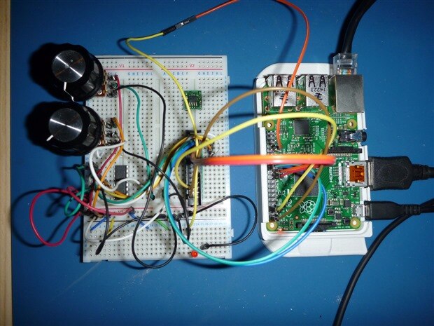

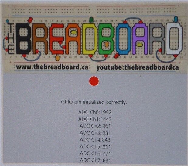

Well I have been playing around with this for the last couple of days and I have to say
HOW WRONG THAT THOUGHT IS !, see the above image and read on to see how I did it image

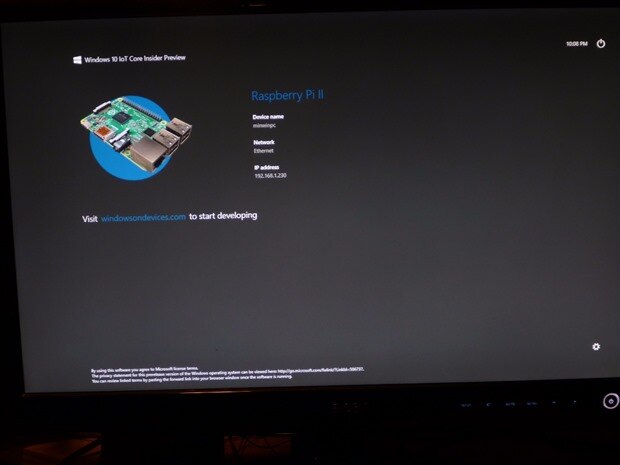

6.    Once you have the image running on the PI then you will see a screen like this
You will notice that it shows you the IP Address and time zone your in. It may take as much as 5 minutes to get this booted up the first time so be patient.

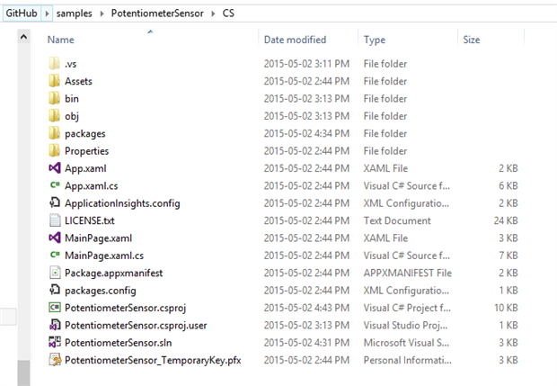

I took two examples from the samples on github, the "Hello World" here: https://github.com/ms-iot/samples/tree/develop/HelloWorld/CS and the "Potentiometer Sensor" from here: https://github.com/ms-iot/samples/tree/develop/PotentiometerSensor/CS, fixing them as described in the video (There are issues with the dependencies and it was easier to create new projects with the same names and copy the primary content over.
The Hello World I left as is with the exception of copying over the core code into the new project. The Potentiometer Code I changed screen layout by extending it to display all 8 channels of ADC on the PI HDMI screen and added a software LED to the GUI. This included extending the code behind to handle all the additional channels.

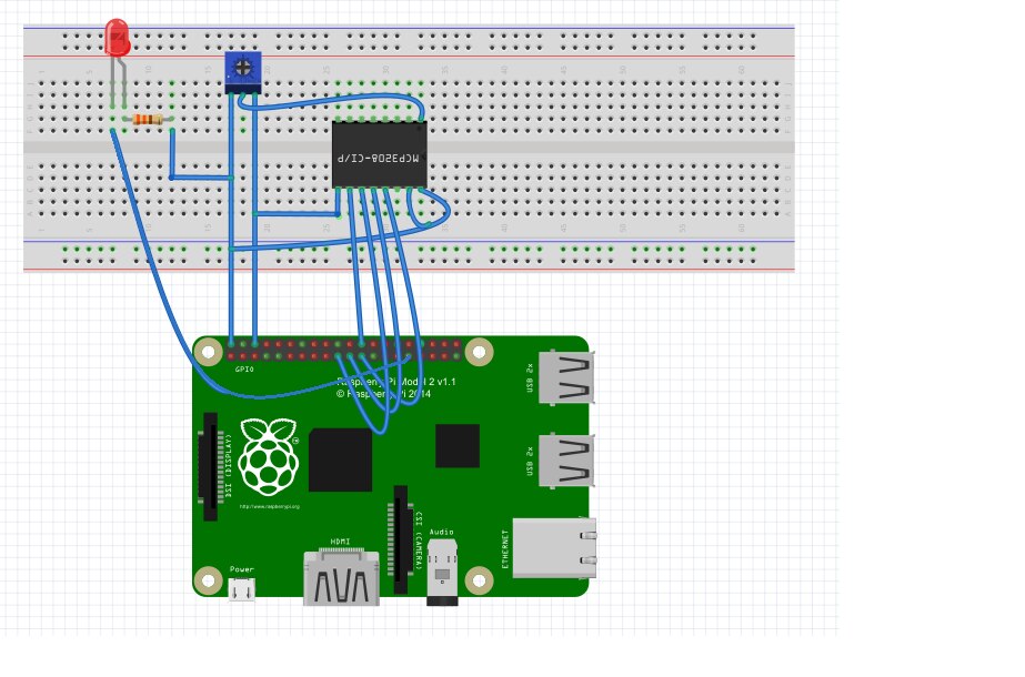

This is the extended files for the potentiometer Sensor Project and the corrected breadboard schematic for the LED wiring

            <TextBlock x:Name="GpioStatus" Text="Waiting for GPIO to be initialized" Margin="10,30,10,10" TextAlignment="Center"  />
        </StackPanel>
        <StackPanel Orientation="Horizontal" Grid.Row="3" HorizontalAlignment="Center">
            <TextBlock Text=" ADC Ch0: " TextAlignment="Left" />
            <TextBlock x:Name="textPlaceHolder0" Text="Show Values 0 Here" TextAlignment="Right"  />
        </StackPanel>
        <StackPanel Orientation="Horizontal" Grid.Row="4" HorizontalAlignment="Center">
            <TextBlock Text=" ADC Ch1: "  TextAlignment="Left" />
            <TextBlock x:Name="textPlaceHolder1" Text="Show Values 1 Here"  TextAlignment="Right"  />
        </StackPanel>
        <StackPanel Orientation="Horizontal" Grid.Row="5" HorizontalAlignment="Center">
            <TextBlock Text=" ADC Ch2: "  TextAlignment="Left" />
            <TextBlock x:Name="textPlaceHolder2" Text="Show Values 2 Here" TextAlignment="Right" />
        </StackPanel>
        <StackPanel Orientation="Horizontal" Grid.Row="6" HorizontalAlignment="Center">
            <TextBlock Text=" ADC Ch3: "  TextAlignment="Left" />
            <TextBlock x:Name="textPlaceHolder3" Text="Show Values 3 Here"  TextAlignment="Right"  />
        </StackPanel>
        <StackPanel Orientation="Horizontal" Grid.Row="7" HorizontalAlignment="Center">
            <TextBlock Text=" ADC Ch4: "  TextAlignment="Left"  />
            <TextBlock x:Name="textPlaceHolder4" Text="Show Values 4 Here"  TextAlignment="Right"  />
        </StackPanel>
        <StackPanel Orientation="Horizontal" Grid.Row="8" HorizontalAlignment="Center">
            <TextBlock Text=" ADC Ch5: "  TextAlignment="Left" />
            <TextBlock x:Name="textPlaceHolder5" Text="Show Values 5 Here"  TextAlignment="Right"  />
        </StackPanel>
        <StackPanel Orientation="Horizontal" Grid.Row="9" HorizontalAlignment="Center">
            <TextBlock Text=" ADC Ch6: "  TextAlignment="Left" />
            <TextBlock x:Name="textPlaceHolder6" Text="Show Values 6 Here"  TextAlignment="Right"  />
        </StackPanel>
        <StackPanel Orientation="Horizontal" Grid.Row="10" HorizontalAlignment="Center">
            <TextBlock Text=" ADC Ch7: "  TextAlignment="Left"  />
            <TextBlock x:Name="textPlaceHolder7" Text="Show Values 7 Here"  TextAlignment="Right"  />

this is a list of the other files in the folder
For an explanation of the code, watch the following video
So as you will see, it is quite possible to create a full GUI application on the Raspberry PI 2 with Windwos 10 IoT. Now go create your own and share.
Oh, a few points to remember,
When entering the Remote PI connection details in Visual Studio, dont forget the default is to use a windows authentication but the PI has this OFF by default so you will need to change the setting when entering the PI address.
The programs from GitHub may not work out of the BOX due to some dependencies that fail on compile. Easy way arround this is to copy the contents of MainPage.XML and MainPage.XAML.CS to a new project of the same name
You dont get a GUI COnsole but you do get a GUI for your apps.
