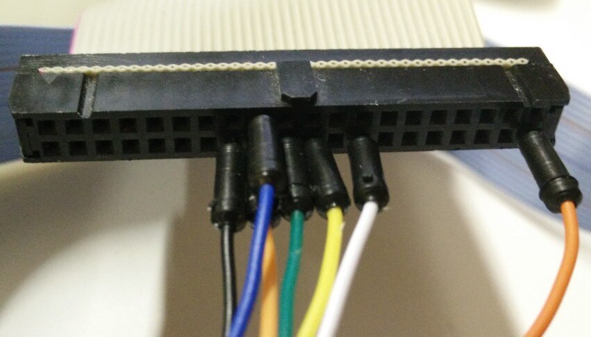

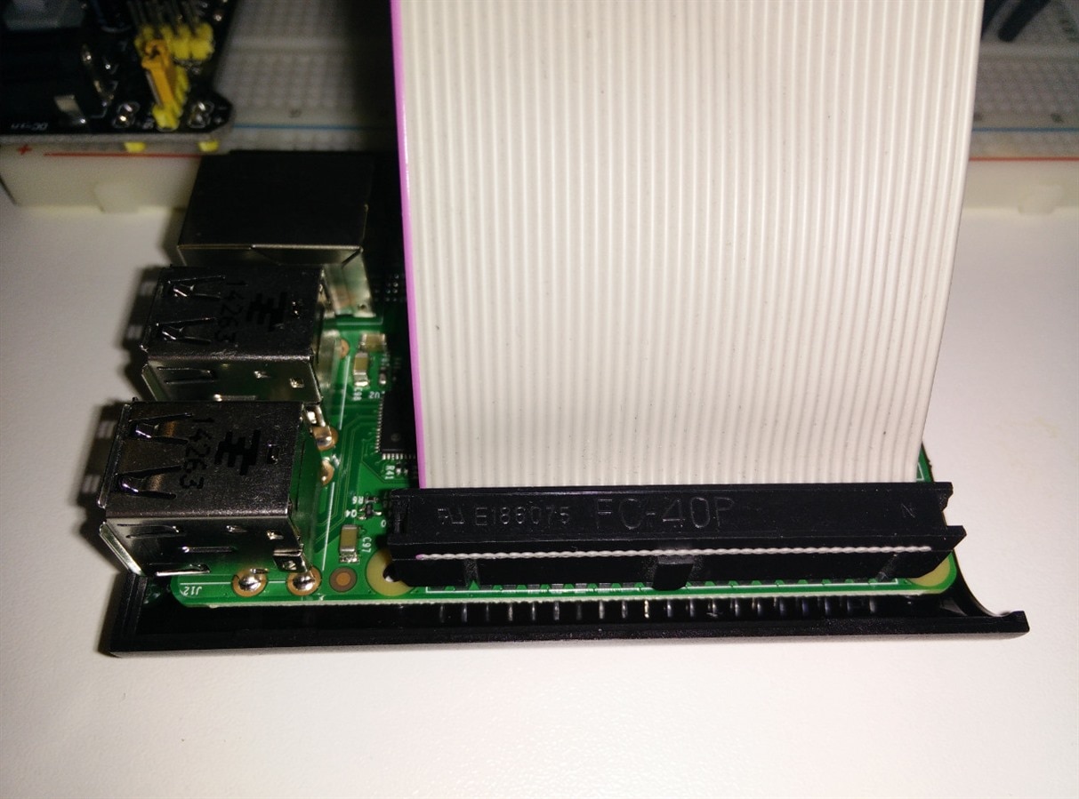

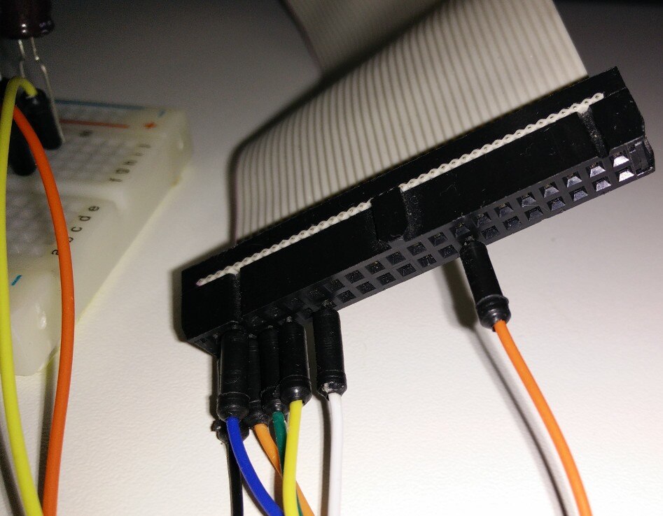

Raspberry Pi (2) GPIO PINs
For both Raspberry Pi's the pins that I use are the same.
P01 : 3.3V : dark orange (*)
P25 : GND : black
P15 : GPIO22 : white (CE)
P19 : MOSI : yellow
P21 : MISO : green
P23 : SCLK : orange (*)
P24 : CSN  : blue
We connect the pins from the RPi(2) to the nRF24L01+ chip. Vcc is 3.3V and for CE we use pin 15 (GPIO22) on the RPi(2). (For the rest we connect the MOSI of the RPi to the MOSI of the nRF24L01+ chip, ... )
In the test setup I used an old IDE40 cable. On both the RPi2 and RPi, pin 1 and 2 are at the edge of the board. Since some pins of the IDE cable are next to the board you will see that the wires on the other side of the IDE cable are inserted in a different position.
(*) It might not be that easy to see the difference between dark orange and orange in the pictures, but the dark orange is the "lonely" cable (7 pins next to the white cable).
IDE40 color
RPi(2) function
RPi(2) pinnRF24L01+ pinnRF24L01+ function20-pin color
dark orange3.3V012Vcc / 3.3Vyellow
blackGND251GNDwhite
whiteGPIO22153CEwhite
yellowMOSI196MOSIyellow
greenMISO217MISOgreen
orangeSCLK235SCKorange
blueCSN244CSNblue
Raspberry Pi 2 B:
The following table tries to show the relation between the pins on the RPi2 and the pins on the IDE40 cable:
__________________------__________________
403836343230282624222018161412108642
39373533312927252321191715131197531
The "---" in the middle represents the notch in the midlle of the IDE cable (see pictures "RPi2: IDE40 ribbon cable / dupont wires").
{gallery} Raspberry Pi 2 IDE40

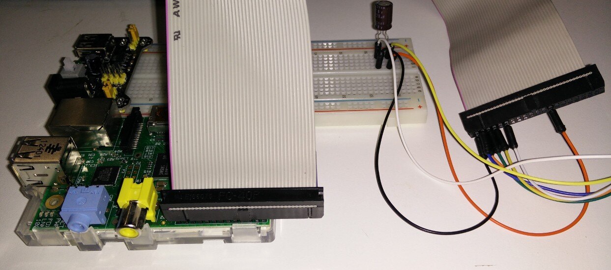

Raspberry Pi B:
The following table tries to show the relation between the pins on the RPi and the pins on the IDE40 cable (xx means not used; pins sticking out next to the board):
2624222018161412108642xxxxxxxxxxxxxx
252321191715131197531xxxxxxxxxxxxxx
{gallery} Raspberry Pi IDE40
RPi: IDE40 ribbon cable
RPi: IDE40 ribbon cable / dupont wires

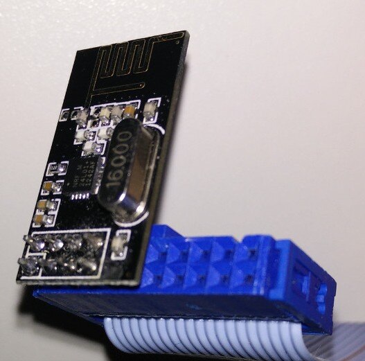

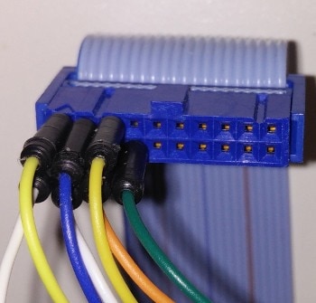

nRF24L01+
"Top" view of the nRF24L01+ chip
|__|__|__|__|--
|___________
2468
1357
1 : GND
2 : VCC (3.3V)
3 : CE    : white
4 : CSN  : blue
5 : SCK  : orange
6 : MOSI : yellow
7 : MISO : green
8 : IRQ : xx
The following table tries to show the relation between the nRF24L01+ pins and the pins on the 20-pin ribbon cable (xx means not used):
2468xxxxxxxxxxxx
1357xxxxxxxxxxxx
{gallery} nRF24L01+
nRF24L01+: chip
nRF24L01+: dupont
